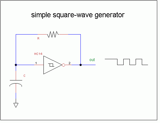

simple square-wave generator

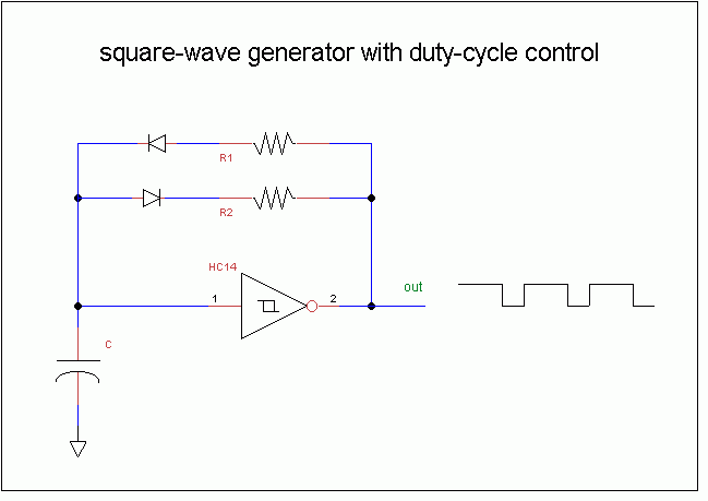

You'll probably get lots of 555 circuits here, but my favorite square-wave generator uses a single gate. You should use a high input impedance, CMOS schmitt-trigger input type like the 74HC14 (or 74HC132 if you want a gated oscillator). It's conceptually simple and works well. The oscillation period is ~ 1.7RC. The first cycle after power-up will be longer than the rest, because the cap has to charge to the STs upper switching threshold from ground. The duty cycle of this circuit is close to 50%, if you want an exact 50% duty cycle, run the oscillator at 2X the desired output frequency and follow it with a flip-flop.
Adding a couple steering diodes lets you vary the duty cycle by controlling the high and low periods independently.
for some more info:
