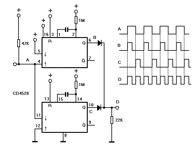

Is there such a circuit as a "Square Wave Frequency Doubler"? I have a square wave of fixed frequency and i need to double it. I.e. the current frequency is 0.5Hz and i need to convert it to 1Hz. How can this be done?

If you differentiate the square wave (put it thru a high pass filter), then full wave rectify the resultant AC, you will have doubled the frequency.

Im sure you can do with a rising-edge triggered d-type a falling-edge d-type and an XOR gate + maybe some extra logic.

The ideas proposed will only work if your "square wave" is truly square, i.e., 50% duty cycle. If it is not, you will need a phaselocked loop. Is your square wave actually square?

Yes. 50% duty cycle.

Yeah that circuit looks great. but what is the HC86 box thing and what are the pin connections shown?
                        | hc86  |
  clkin ----+           |       +--- clkout = 2*clkin
            +-N-R-+-N---+       |
                  C     +-------+
                 gnd
where N is a NOT gate (hc04?)
      R is a 10k resistor
      C is a 47pf capacitor.

Never mind... it's an XOR... **broken link removed**
Sorry :oops:
This circuit works fine.
hey, i'm also looking for a frequency doubler, i had a look at that circuit and i got a few questions. the CD4528, is that just draw in two pieces when it's actually one and also if i put say, 2Hz on the input, on the output would i just get double the frequency and what the input and outputs are, thanks
