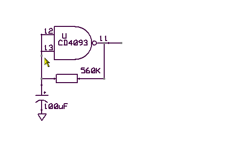

hello i have to design a schmidt trigger square wave osicilator using 4093.
help me to find a simple circuit diagram thanks
hi,:)
Something like this.
Change the Res and Cap values for other frequencies.
