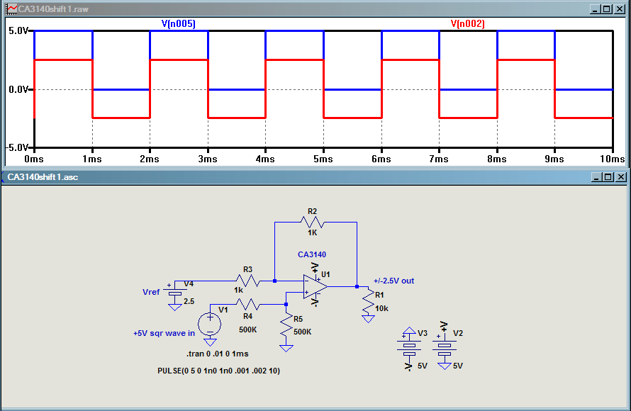

Hi all,
I have what seems like a simple problem, but I've been unable to find the solution.
I am using a PIC to generate a square wave. The problem is that the piece of equipment to which I'm sending the square wave requires the wave to cross through zero volts - so in other words, instead of a 0-5V square wave that the PIC generates, I need to make it into -2.5V -> +2.5V. Or -5V to plus 5V. It doesn't matter what the voltages are, as long as they're approximately the same, and the signal crosses through zero volts.
Is there some sort of chip or circuit I can use to do this?

An OPA with a gain of 1 and a 2.5V offset would do the job.:)

Look at this image.
Its for +/-2.5Vout
If you want to goto +/-5Vout the +/-5V supplies have to be +/-9V
also the feedback resistor has to be increased.
Blue is input, Red is output

Thanks!
Wow, thanks a lot!
That is exactly what I was looking for.
I can certainly build that - looks pretty simple.
Of course, my next dumb question would be, how do I create the negative and positive supply voltages? This circuit is meant to operate in a a car, where all I have is +12V. I understand how to use a 7805 to make +5V, but how do I then make -5V?

AC couple the signal and referance back to ground.
From the PIC run the signal through a 0.1uf capacitor. Then connect the output to ground with a 10k resistor. Now the signal will center around 0 volts and swing +/-2.5 volts.

A 0.1uf + 10k will have a 160hz high pass effect. At 8khz you will not see much effect. At 200 hz the square wave will be distorted.
If the capacitor was a 10uF ele. cap then the high pass corner will happen at 1.6hz.
This assumes your load (the equipment you are driving) is high Z (100k ohms or more). If you load is 50 ohms then you need 100uF 6.3 volt cap. (30hz high pass)

Using LTSpics sim, shows that for a range of 200Hz thru 8KHz using the cap coupling circuit, the square wave for some frequencies pass thru without the required V/2 offset.
Say what? If you AC couple and referance back to GND it must center at ground. If the RC time constant is 0.1 second, then spice may need to simulate out for 200mS to get the right results.

Eric, I agree that it will take time. I was thinking that creating -5 volts from +5 and adding op-amp etc will take time to solder up. Just use a capacitor and maybe a resistor and your done. With a RC=0.1 sec it should be very very close in 1 second. Look at the RC charge up curve. In 10 time constants you are very close. He is just driving a frequency counter machine that usually gets a sign wave. If the center is off by 30% there will be no problem. In time the center will be 0.

Actually, now that I understand I little bit more - I think I need the op-amp solution.
The timing of the pulses is very important - and constantly changing. The whole purpose of the PIC is to modify the timing of the pulses - so if the pulses are delayed by the RC circuit, then I won't have achieved my goal.
The op-amp solution will have very fast response time (I'm sure fast enough), and will work at all frequencies - correct? I'd rather have more circuitry than a mis-timed signal.

hi Chris,
I did think initially you had a -V supply on the existing circuit that could be used by the OPA, the CA3140 costs about 60pence GB.
We could use a 7660 for the -V as you suggest.
The point is adding this extra cost brings the total cost close to a MAX232 solution.
The only downside in using the MAX is that the output swing would be in the order of +/-9V.
You could reduce this to a lower voltage by using resistors and zeners.
Get the MAX232 datasheet and check to see if it would be suitable.
Ron,
My concern in using the R/C method, is that as the input frequency is changing from 200Hz thru 8KHz and the 'load' device is counting the zero crossing points.
There is a chance some thru zero swings, after a pause in the incoming pulses, could be missed.
