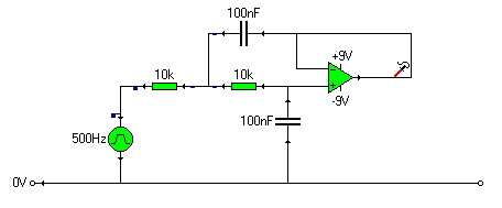

A square wave is a complex wave, composed of sine waves of the fundamental frequency, plus every odd harmonic (3rd, 5th, 7th, 9th...) up to the infinith harmonic (in theory, anyway).
If you feed a square wave into a low pass filter, tuned just above the fundamental frequency, you should get a pretty clean sine wave out.
For reference, here is a basic active low pass filter:
In the function generators first feed the square wawe to integrator. The output is triangle wawe, and with diode limiter circuit make sinus.
Seems to me that it would be simpler to convert your guitar output to a square wave using a comparator with hysteresis (Schmitt trigger), and then compare the frequencies of the two square waves.

If you go with Phasors idea of low pass filter, you really should make a band pass filter tuned to the frequency you want. The low pass will pass all lower frequencies as well and add to the distortion. Also, if you use the diode limiter version (from triangle) wave be prepared for significant distortion there too.
