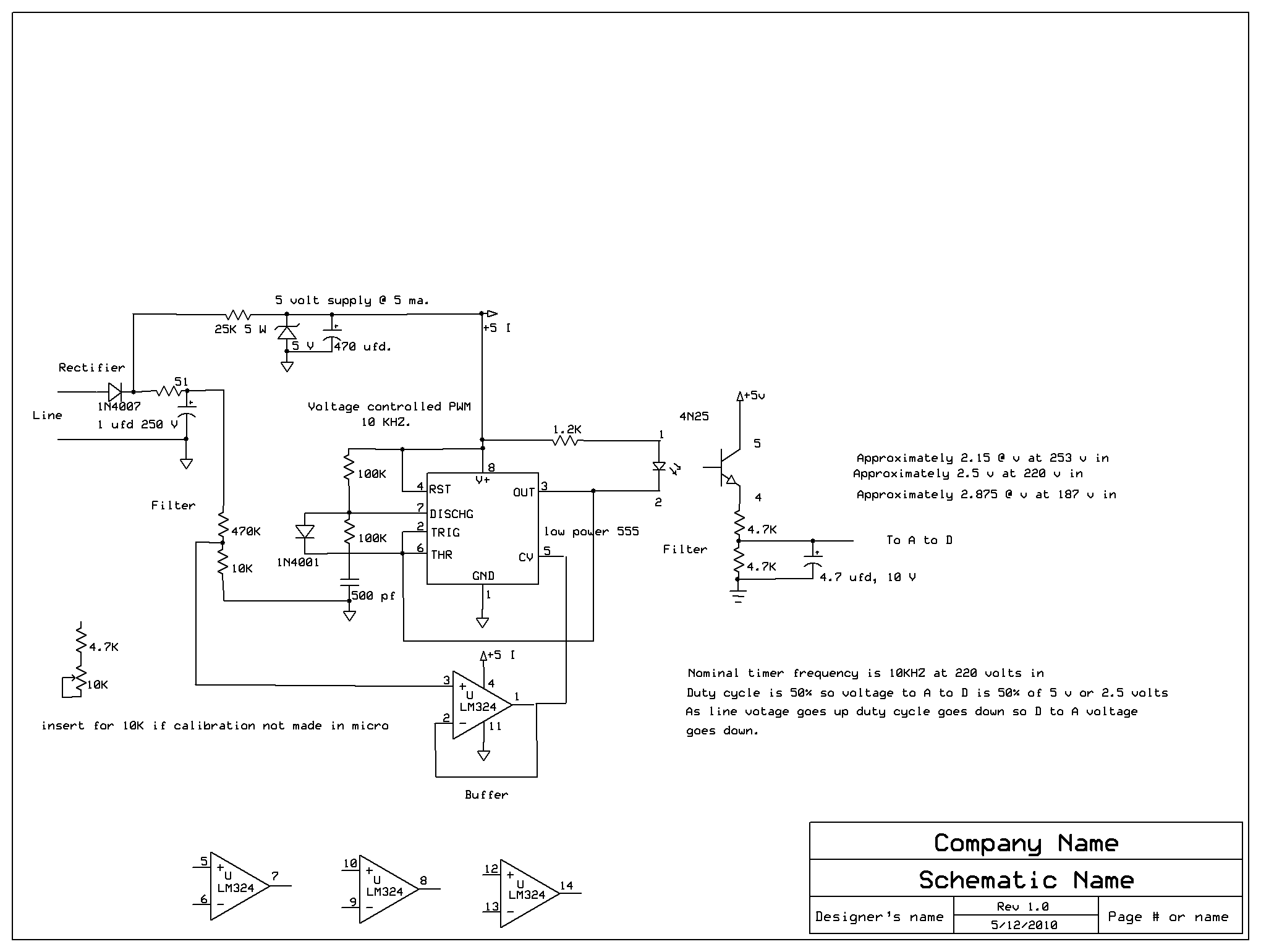

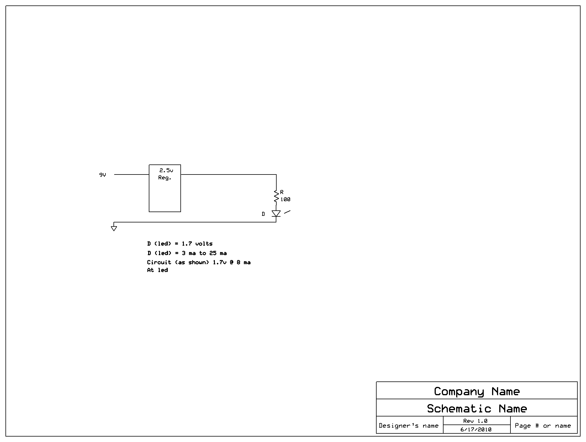

Just to make sure...... Will your circuit look like this?
Oops
Don't know where that schematic came from.
Why bother with the regulator? If you have 9V, and you want to turn on the LED, and if the Forward Drop of the LED is 1.65V, then just use a resistor = E/I = (9-1.65)/0.02 = 367Ω (use a standard value of 360Ω).

hi ronv , i do electroincs by trial & error, as i was never taught well at school, so unfortunately i can not make head nor tails of the diagram you posted. but hey it all works now, i use a 2.5v regulator, with capacitors to make sure the power is smooth and a 220 ohm resistor. the relay switches very quick , it works fine. : P
