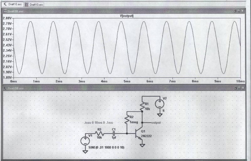

It looks like your circuit works pretty good. With 10 millivolts input, the output is about 1 volt. You might need a second stage, if the signal is very weak. You will need a volume control between stages or the second stage will overload and distort. The gain is very much dependant on the source impedance, in this case I assumed 10K. If the impedance is lower, the gain will be higher.

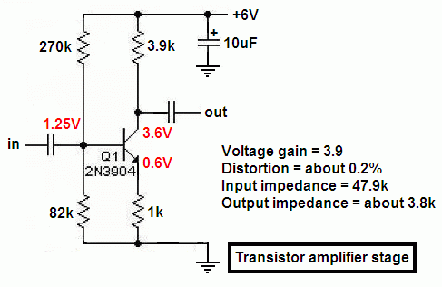

1) Try it with a 6V supply.
2) Choose a 3.9k resistor for the collector resistor.
3) At 10% of the supply, the emitter's idling voltage will be 0.6V. The collector will swing from 6V to about 1.2V.
4) Therefore the collector's idling voltage will be half the swing which is 3.6V.
5) Therefore the collector and emitter current is 615uA (Ohm's Law).
6) Therefore the emitter resistor is 1k (Ohm's Law again).
7) The base voltage will be about 0.65V higher than the emitter voltage (from the transistor's datasheet) so the base voltage will be about 1.25V.
8) Most transistors have an hFE of about 200 so the base current is about 3uA.
9) Choose a base to ground current of 5 times the base current which is 15uA. Therefore the resistor is about 82k.
10) The 1.25V base to 6V supply resistor will have 18uA, therefore is 264k, use 270k.

Hi Russ,
I figure that your transistor will have about 2.5V at its collector.
The collector voltage and the gain will change a lot with the wide range of hFE values for the transistor. :roll:
With the huge input cap, I figure its lower response is at most 15Hz. :roll:
Can you measure its distortion when it is near clipping? I figure about 12% which is pretty lousy. :cry: :lol:
How did you arrive at that figure for input impedance?
Hi David,
The input impedance of the transistor is its typical hFE times the 1k emitter resistor (actually it is slightly higher due to the transistor's re), in parallel with the parallel combination of 270k and 82k. :)

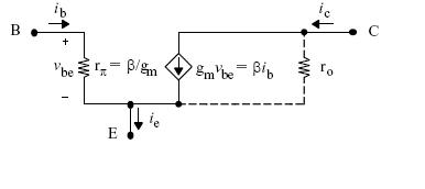

Here is what the a BJT amplifier looks like when modelled with discrete components, not that the DC biasing supply has been grounded (AC signal is superimposed), the biasing current has been modelled in terms of r(pi). All the other resistances come in parallel, at either the input or the output side. U can now figure the impedance out. The capacitors, if the reactance is very small(1/2(pi)fc <<1) can be ignored.
