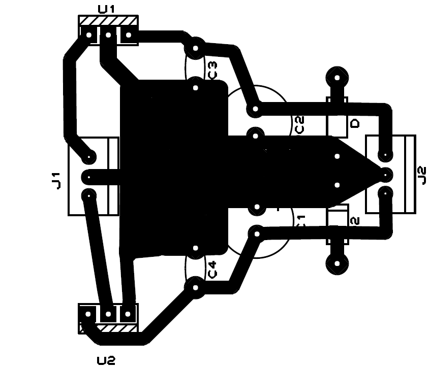

I am designing a dual power supply based on 7806 and 7906, Now I do not if I should polygon the PCB of the said power supply or not?
Any idea bout pores and cones plz?
To star or not to stat.
I often use a combination of ground plane and star. In the case of a dual power supply, I might pore a ground plane around the LM7806 and a different around the LM7906. Then connect the two together at the output jack. Any time you have two different circuits it is OK to keep them separated and then connect them at one point. I can't see what you are doing! This supply is so simple I think you can do what you want. A good healthy ground never hearts. I would use ground across as much of the board as you can.
Hi, And thanks a bunch.
I agreed that it is good to use a star ground to connect the power supply unit to the other circuits (bloacks). But I would like to see if it is a good choice to use ground plane for the power supply unit itself?
PLZ,What is your idea about the dual power supply PCb I have designed?
