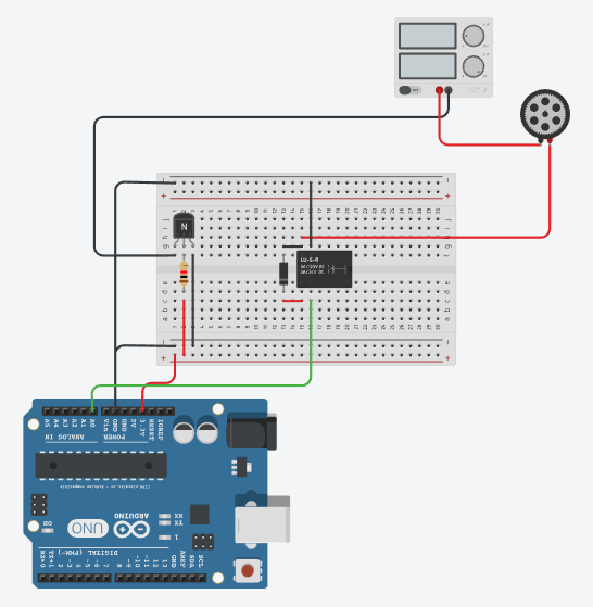

.... yah , even though arduino is 5v you are on 3.3v pin
also your relay is hooked completely wrong... you do not wire it like a transistor, you are completely missing 2 wires !
the arduino should be attached to the coil in the middle and should lead to ground to close the circuit, and actually, that 5v power pin will want to be moved to your output pin so the relay isnt always "ON" , the device being switched should be on the outer contacts of the relay and should use the "switch " diagram as shown for the corner pins
so your arduino ground is hooked up ok, but even if you were using the 5v pin on arduino it goes nowhere, you need to hook it to the other side of your switching coil
on the switch side of things, you need to move either ONE of those wires to the other side of device
here is a diagram that shows how the relay works better... which is again different from a transistor

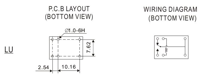

Note that you do not have the motor side of the relay wired correctly. Look at the pin out, below:

I have redone the relay wiring to start narrowing down my mistakes. So far i've gotten this to work according to the circuit.io simulation.
https://circuits.io/circuits/3374128-relay-test
(yellow wire connected to the power for test, should be connected to a gpio pin)

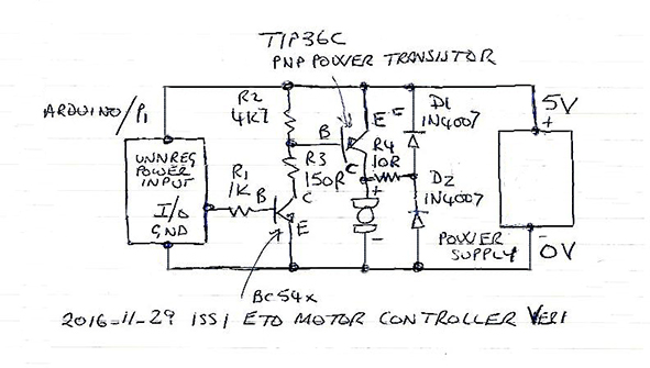

Why did you change from a momentary relay to a latching relay???
Well spotted Mike. I had not noticed that rafvervink has now changed over to a latching relay. rafvervink, What is the reason for choosing the latching relay ? The schematic I posted will not work with a latching relay. The simplest circuit I can think of to drive a latching relay from one I.O pin would require 3 transistors and a fairly large value capacitor. (Non polarized capacitor)

Hi rafvervink,
Below is a circuit for you to consider.
spec

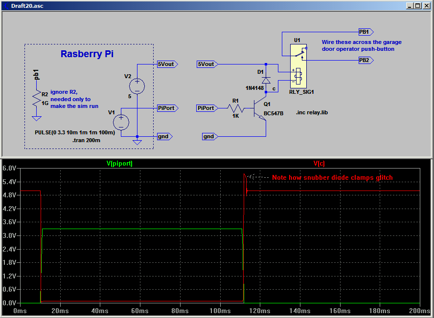

Ok, now one more confirmation: The Rasberry Pi port pin, does it put out 0V(low) and 3.3V(high) , or does it put out 0V(low) and 5V(high)?
Postscript: I answered my own question by reading this.

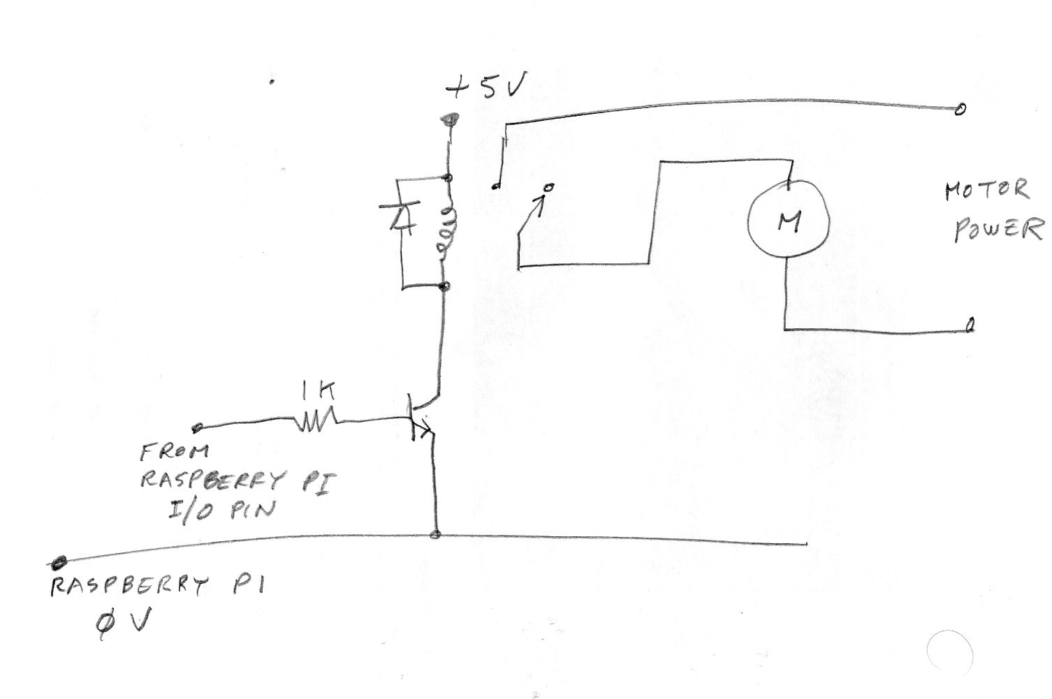

In that case, here is what I would recommend:
Note that the "button" is pushed while the port pin is "high".
When I finally realized that the Pi's port-pin only puts out 3.3V, then driving the relay directly is not possible, and the switching transistor is required. Note how the snubber diode clamps the collector voltage just 0.6V above the 5V supply voltage as the transistor turns off. The snubber must be used... The actual coil current of the relay becomes less important; the original 40mA relay you showed would have worked...

Super, thanks! As you found yourself, they indeed output 3.3v. Can I still use the relay you proposed (even if i need to add a transistor)?
I'm gonna read up a little on the diode, but i understand your circuit.
As for the open/closed, i already got this working with some magnetic sensors! Only downside is that i need rather long cables running over the ceiling of my garage.
I can't wait for the stuff to arrive and start testing this out
Yes
