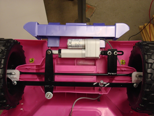

Does anyone have an idea ( or even picture or maybe a link) which shows how to create a mechanism to steer the front two wheels of a car.
To be more precise: I want to give out "logic 1" (voltage/current not much of an issue as that can be worked around) to activate some sort of motor (possibly a solenoid???) to push the front axle left or right, without actually causing the motor to turn around with the axle. Do I have to connect the wheels to pivots or something? I have tried to open up a couple of RC cars to no avail.

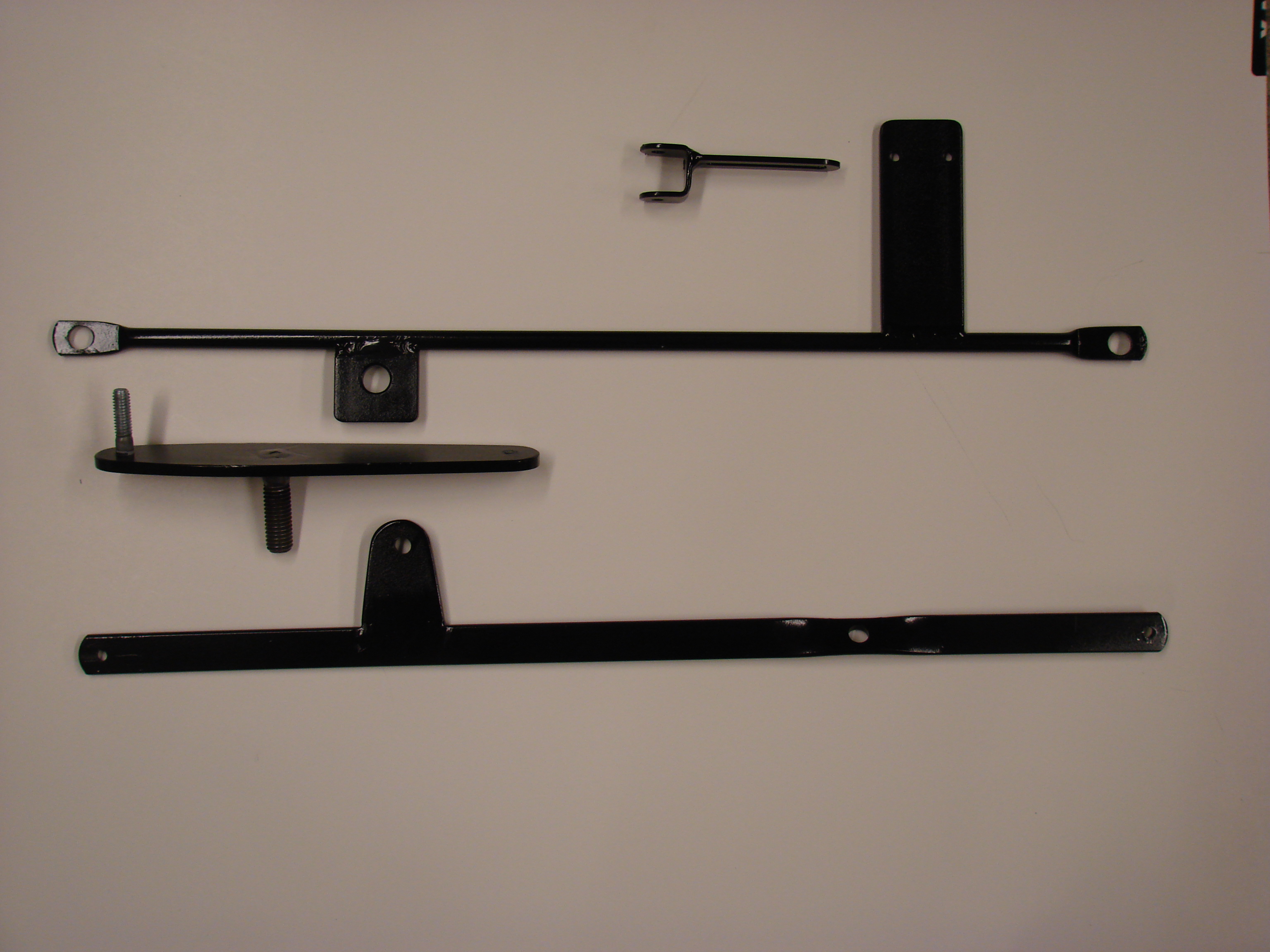

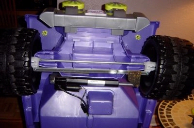

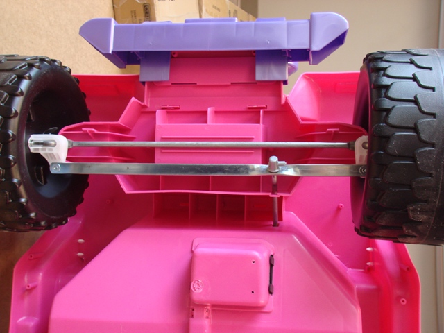

This is the steering linkage to a linear actuator I made for a Power Wheels Jeep (the pink one). The blue one is someone else's design.
Ken

Hi ken, thanks for the pictures, they do seem to be what I am looking for. I am making an RC car, controlled by IR. I have already programmed my PICAXE chips, but the only obstacle is that of the steering mechanism. I know it's a big ask, but I can't really understand what is happening in the pictures. Could you pretty please explain the components and their function in the mechanism?

The blue Jeep is the easiest. The steering wheel shaft has a dog-leg at the bottom end, that passes through the twisted section of the flat bar, near the right end. The steering wheel shaft and dog-leg forms a crank that pushes the flat bar to the left and right when rotated. The plastic axle-mount arms, connected to the flat bar, pivot and rotate the wheels. With the linear actuator connected to the flat bar, it can push the flat bar left or right, implementing steering.
Mine is more complicated because I wanted to use the full range of a short linear actuator with its internal end-stop switches. That required a compound lever mechanism to match the actuator stroke to the maximum movement of the flat bar.

Ken, thanks for the info. I could really trace what you described to the pictures. Thanks again.

I think there may be a misunderstanding of the difference between Ackerman steering and the linkage in vehicles like the Power Wheels Jeep. In the PW Jeep, and probably many other simple vehicles, the dog-leg arm that is angled rearward from the axle at the pivot point is at a 90° angle to the axle. In the Ackerman linkage, the angle is less than 90° from the axle, causing the difference in pivot-angle of the two tires during steering. https://en.wikipedia.org/wiki/Ackermann_steering_geometry

Ken; You are right. Looking agin to the photos, the HotWeels use parallel steering.
Look here; It shows both types.
