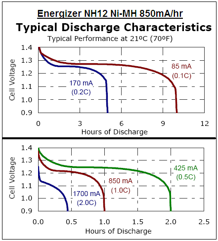

The Energizer AAA Ni-MH rechargable battery cell has the highest capacity that I've seen. It has 34% the capacity of their 2500mA/hr AA cell.
