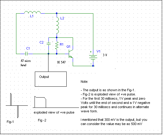

All details are given in drawing. could you comment.

The 300 ~ 500 mV pulses are rather small. They would need to be amplified. Does anyone know of a low current amp?
Or a low current Schmitt Trigger that can be set/reset by the pulses. Another possibility is a low current bistable (Flip Flop) that can be set/reset by the pulses. Any suggestions?
Alternatively, can you take the pulse from the junction of L1 and C1?
If so, what amplitude is it? Is there any ringing? Obviously it will be centred around +3 Volt, but that will not matter if the amplitude is adequate. The issue with taking the pulse from the right hand side of C1 is that it is clamped by the transistor BE junction.

radhi said:
A simple electronic circuit is built in to drive coil-1 which imparts pendulum to move to and fro and the other coil-2 generates 300 mV due to magnetic flux.
You appear to have transposed the coil numbers. In your circuit, you have shown L2 as the driving coil. But in the quote above it is Coil-1.
If the pulse at the junction of L1 and C1 is large enough, the amplifier won't be necessary. If not, then the insertion of a resistor may provide enough amplitude.
[You appear to have transposed the coil numbers. In your circuit, you have shown L2 as the driving coil. But in the quote above it is Coil-1.
- Yes i agree with your observation. L1 coil is the sense coil and L2 coil is the drive coil.

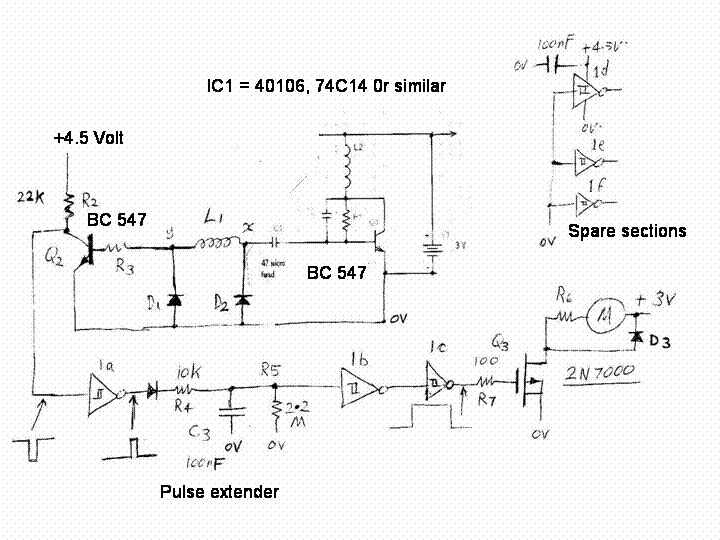

Here is a suggestion. I don't know if it will work because I don't know the amplitude of the pulse from L1.
If the voltage generated by the coil is too small, then Q1 will not turn on due to the voltage dropped across D1.
If so, then another transistor will be required.
R6 is to limit the current through the motor to the required level.
R3 may be necessary, depending upon the resistnce of L1.
Q1 turns on when x goes positive and Q2 turns on when y goes positive. The pulse from Q2 is stretched by C3 R5 and should be about 200 ms with the values given; but given the wide spread of the CMOS Schmitt Trigger thresholds, you may need to vary R5 to suit.

[R6 is to limit the current through the motor to the required level.
- what should be the approx. value of R6?
- what should be the approx. value of R3 ?
Will the output waveform would be like given below in attachment.
- what should be the approx. value of R6? I don't know, it depends on the current drawn by the stepper motor. Only you can answer this question.
R3 may be necessary, depending upon the resistance of L1.
- what should be the approx. value of R3 ? I don't know, it depends on the resistance of L1 and the voltage generated by L1. Only you can answer this question.

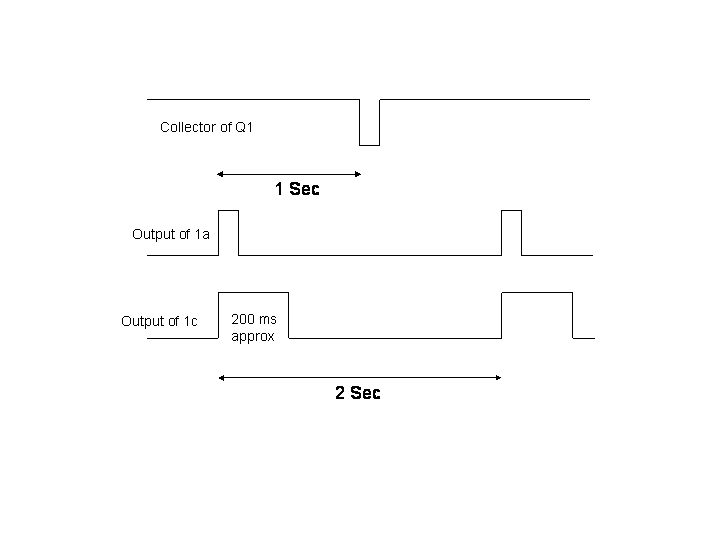

The waveforms below are my understanding of what you asked for.

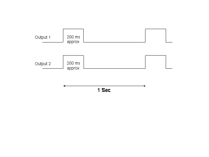

quote
The required circuit shall generate the following:
a) output of 1 Hz with 20 to 30 % duty cycle with positive 1.5V or 2 V peak.
b) second output of 1 Hz with 20 to 30 % duty cycle with positive 1.5V or 2 V peak - AFTER 1 sec."
This does not make sense. The attachment below shows, a 1 Hz signal delayed by 1 second is also a 1 Hz signal.
What I need is a timing diagram of what you need.
Your attachment did not help me at all.

ljcox said:
quote
please see attachment the timing diagram .
  • output_wave_detail_time_base.doc
Your output 1 and output 2 have 2 second periods and are therefore 0.5 Hz, not 1 Hz.
And they are very similar to the diagram I posted on Dec 26.
The duty cycle can be adjusted to whatever you need.
However, I am dubious about the output from L1. I expect it will give a positive and negative pulse each time the pendulum passes it, not positive pulse on one pass and a negative on the other. Are you sure that your L1 waveform is correct?
