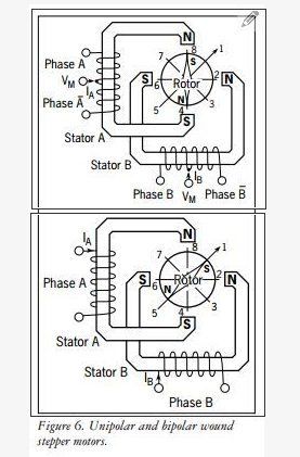

(PS: my understanding is that a six-wire stepper motor has two center-tapped coils and that driving a six-wire stepper motor in unipolar mode means that you just ignore the center taps on each coil and treat the stepper motor as a four-wire stepper motor and drive each coil with a unipolar signal ie 0V to 9V say)
That would bipolar mode.

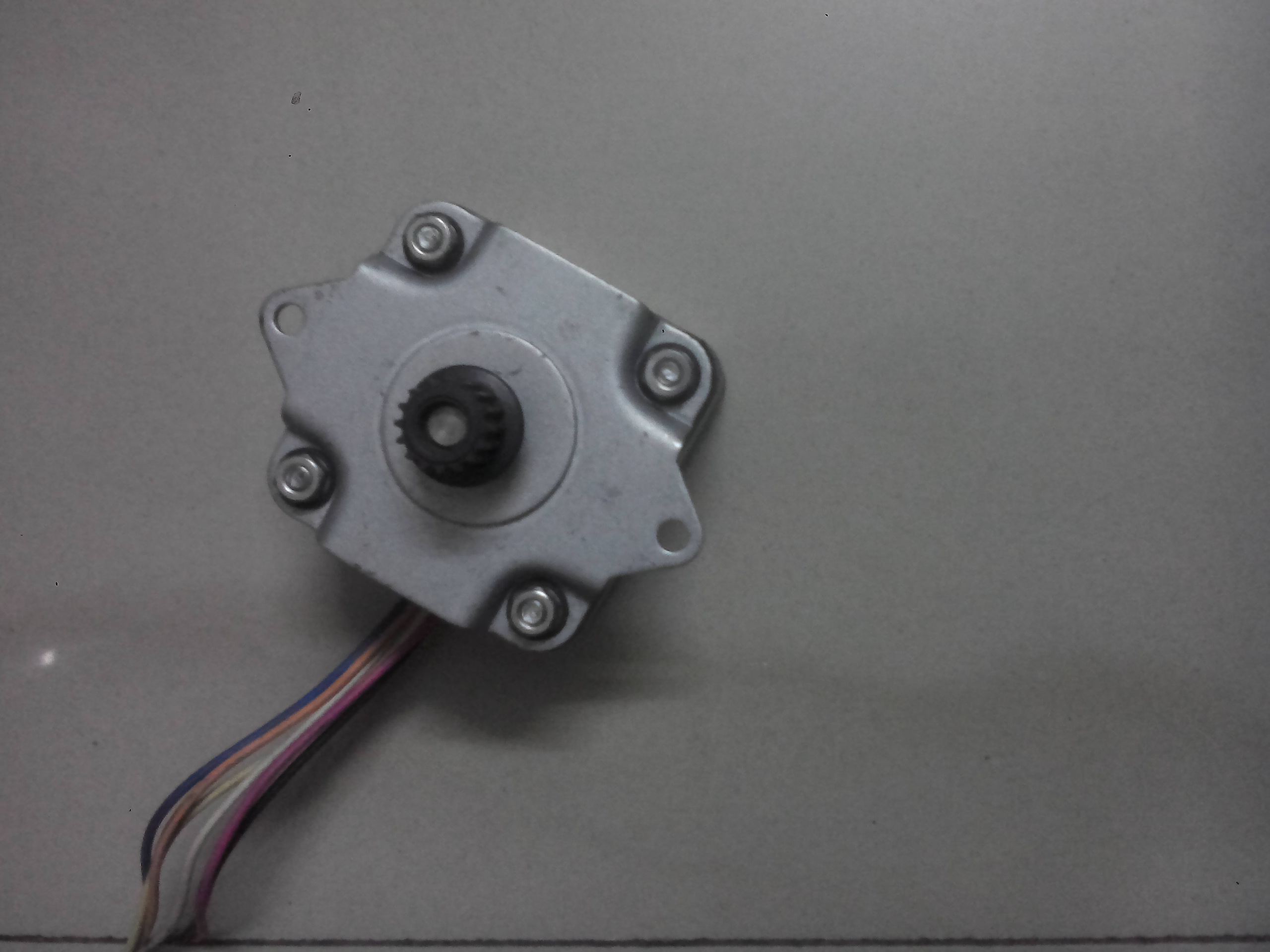

Sorry nothing is written on the stepper motor so not able to say anything. But here is the picture i have taken.
Looks like a Nema 17 sized motor, is it roughly 42mm x 42mm?

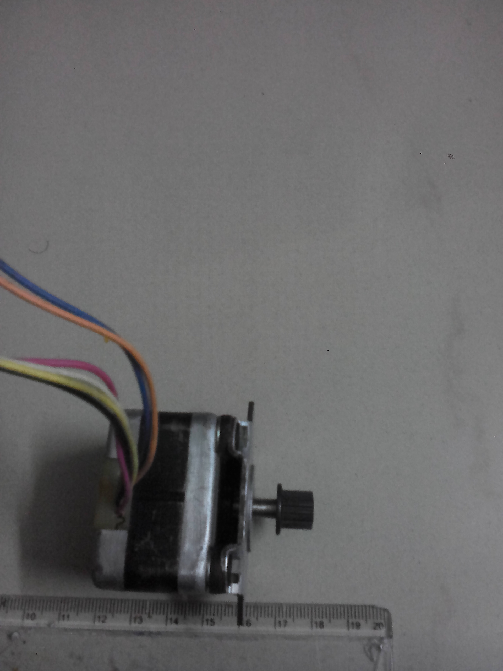

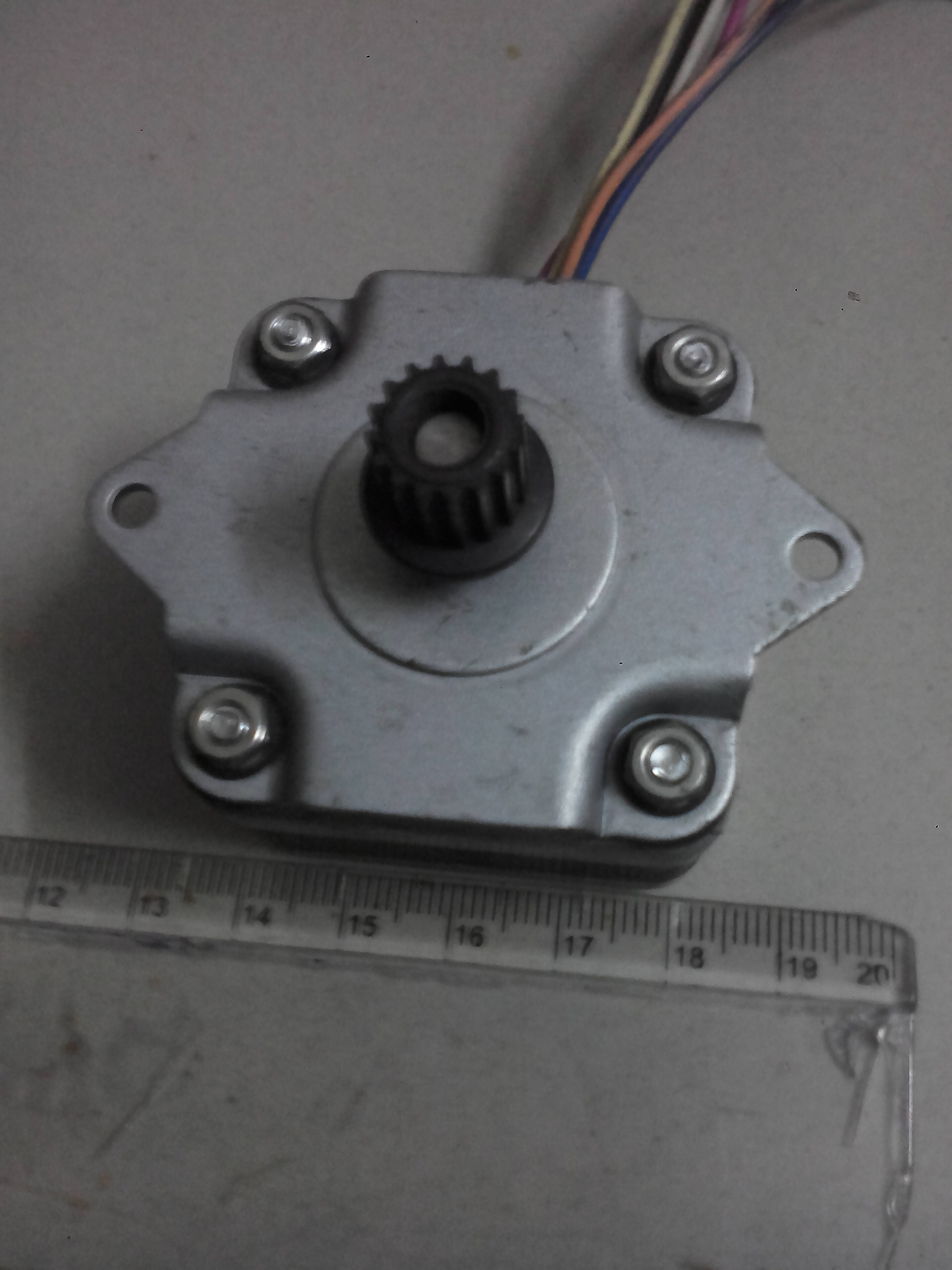

The size is approximately I think is 40 x 30 mm I think, I have attached the pictures. I plan to drive with arduino board and test my luck.
The stepper you have in your picture sort of matches with these 2 on ebay, from the mounting plate attached.
Minebea 17PM-J204-G1ST:
Minebea 17PM-K207-P1ST:
The size fits for a Nema 17 type, but you will not find an exact match because those motors have been pulled from an office printer or similar.
The Minebea numbering system is explained in the datasheets, but as this is a custom stepper, like those above, exact details will not be found.
The best thing you could do to try and work out what you have, would be to look at the tables for Nema 17 motors and match up the body dimensions,
winding resistance & inductance, motor cap and total mass. Motor cap means the end plates - are they pressed steel or aluminium?
If you can match up those parameters, you are a lot closer to finding the best specs to operate with.
