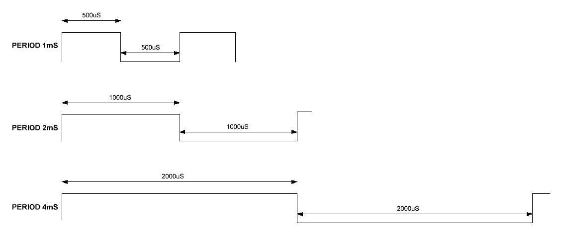

I have a 4 wire stepper motor. What type of Timings need to rotate stepwise? I want to turn the motor at different speeds. Is this ok? Or is this High pulse (mark time) is too much for each periods?
I'm feeding this 5V microcontroller pulse to the TB6600 stepper motor driver.
According to the datasheet at https://components101.com/sites/default/files/component_datasheet/TB6600-Datasheet.pdf the pulse train can be up to 13 kHz with a 50% duty cycle, so yours at 1 kHz would be fine.
The pulse train can be up to 20 kHz with a 75% time low. That is a time low of 37.5 μs. At 50% duty cycle and 13 kHz, the time low is 38.4 μs, so it seems that the time low is the limitation and shouldn't be less than 37.5 μs, but the time high can be a lot less.

To interface with this controller, you use fixed pulse width negative step pulses, say 40 us, then choose when to send these step pulses according to distance using your calculations using an optimum acceleration in both polarities, with a max velocity due to friction with the max. frequency of step pulses around 20 kHz.
This will travel a certain linear distance with a belt around a given diameter pulley and most steppers are 200 full steps per revolution.
Acceleration= start ++++0000 - - - - stop for example.
Velocity = 0 1 2 4 4 4 4 2 1 0 stop
Position = moves number of steps / N for N = 1 to 16
Full Steps N=1, have the most torque, acceleration and noise. Half steps may be a good compromise.
Bigger fractional steps are just the opposite but allow fractional step position control.
It is not as you have shown with divide by two square waves.
The algorithm for acceleration and velocity is critical to performance and depends on torque, friction and inertia.
