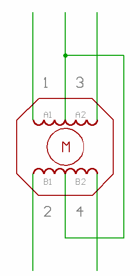

Hi things,
I doubt your results a bit.
A bipolar motor with two center taps connected to one wire must have four identical resistance values (+/- tolerance) from the center tap to each outer end of the two coils. Both outer ends must logically have the double resistance.
They are not connected to any other wire within the motor.
You measured four times ~58Ω and six times ~116Ω, which makes no sense for me.
I agree that red must be the common center tap connection though.
Attached is a schematic diagram of a bipolar stepper motor.
I suggest to use the red wire for center and try all other connections to see what happens.
Boncuk

Isnt that a unipolar motor? The way to drive it is to connect the red
wire to V+ and connect the other four wires to the collectors of
some NPN transistors that are driven with a unipolar driver.
This kind of motor is problematic in that you can only use a unipolar driver.
If you try to run it as bipolar, a problem will occur because the two center
taps are connected together. More often a unipolar has six wires, where
the two center taps are independent, and that gives you the option of
driving it with a bipolar driver (at reduced power).

From your limited measurements that schematic that Boncuk drew up looks
accurate so i'll repeat it here...
Of course it's a unipolar motor, the same I added as a schematic.
Blame it on my language barrier. :)
I sometimes mix up unipolar and bipolar.
Boncuk
