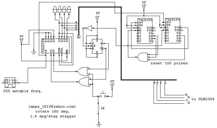

hu has circuit for stepper motor to rotate from 0-180 deg. back n forth continous...plz....using registers ttl ic's.

parts list:
555 (create astable freq.)
74194 - for shift right shift left
7476 - FF. q and not q connected to s1,s0 of 194
unl2003 - stepper motor driver
zener diode 12v
2pcs 74193 (make a binary of 100dec then nand to cp of FF....

AMPdeck said:
parts list:
zener diode 12v
stepper motor which has 1.8deg per step.....
AMPdeck: With those parts it sounds like you are in the right way to make it happen, I would be interested to see what you done for kicks.
Have in mind that it would have been easier to use a L293 + L298 combo (or similar chips) with a microcontroller, for practical purposes. But for learning purposes on how things work, your way is the best 8)

mates, check out my schematic for a stepper motor that rotates 180 deg. then vice versa.....ideal for eletric fan......
