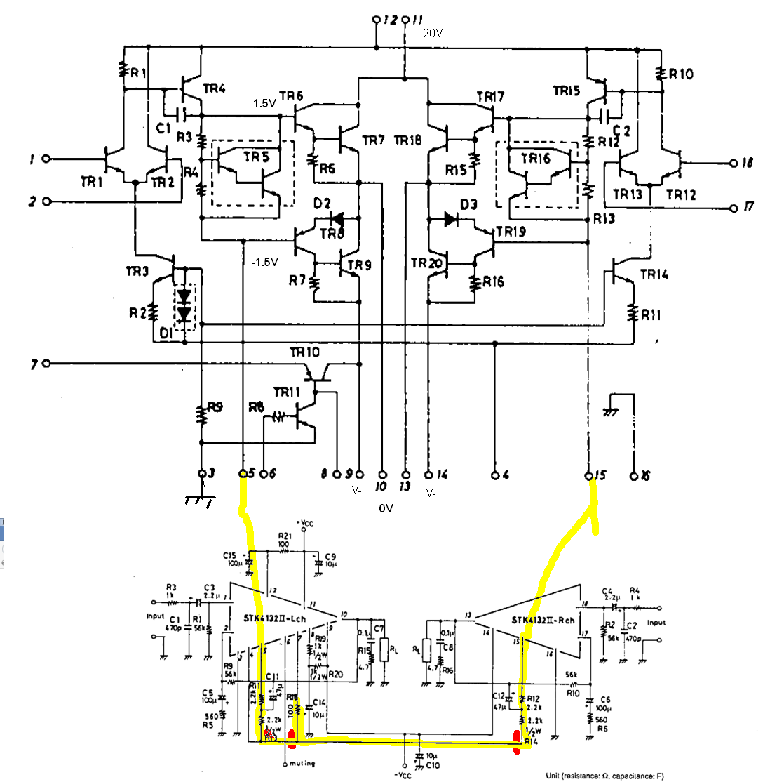

Hi ppl.
My sony audio box has its audio output distorted like this:(attached)
What do u think about this failure?
Thanks .

Thanks Nigel for your reply.:woot:
Unit is SONY FH-B170 n distortion is more obvious at low volume, at high vol, positive and negative half cicles look pretty symmetrical.
I will try another stk, and then will open the bad one to look inside.
The stk makes the same effect on this working board: (inside stk.bmp)
I will trace the input signal in its way to the final stage, to see what happens...

This is classic collector emitter leakage resistance across a cascode stage before complementary emitter follower stages. The result is insufficient DC bias for just one polarity .
It would be on the high side PNP transistor that leaks starving the low side of DC bias so they do not overlap at 0V. Diode tests won't work.
Unfortunately without a schematic , I can't give you the Ref Des.
but if you put your finger across the collector emitter of the "right" part with a light touch (100k) you can make the signal worse and thus replace it. There should be a bias pot to null crossover distortion, but that may not work.
Does the distortion occur on left and right channels or just one ? Are the positive and negative supply rails about the same voltage ?
Les.
Comparing DC levels from left to right ought to isolate the small signal crossover issue, especially pins 5,15. then observe wave there.
Les.

Inputs are biased negative too much
Pin 3,4 please
With no input signal can you list the voltage on all pins of the STK4132II module as measured by a voltmeter, with reference to zero volts on pin 16 ?
spec
yes especially one side all pins incl pins 1-10
I have a hunch the mute control is partially to blame
1: -145mv
2: -145mv
3: 0v
4: -19v
5: -100mv
6: 2.7v
7: -20v
8: -21v
9: -21v
10: 30mv
11: 21v
12: 20v
13: 40mv
14: -21v
15: -80mv
16: ov
17: -120mv
18: -125mv
STK actually goes muted when I short together collector n emiter of tr11 btw.
I have just removed mute transistor TR11 without improvements.
Check R16 100Ω ( connected to pin 7) but not connected to R13,14 affecting Vdc at pin 5,15 , yet R16 is connected to pin 4
Can you measure the voltage on TR6 base and TRB base with respect to 0V
I am a bit suspicious of TR8, TR9, or even possibly D2.
After that C11, 47uf bootstrap capacitor, may be faulty; it might be worth changing it anyway.:)

Are you not aware that those components are in a hybrid IC?, so it's not easily possible to measure voltages inside it - although breaking the casing off 'may' allow you to do so.
I've repaired countless amps using these kinds of hybrids, in almost all cases the hybrid needs replacing.
In the data sheet link that spec provided in post #9 there is a note on page 6 (External component description) that says about the bootstrap capacitors (C11 & C12) "If these capacitors are made too small, then the total harmonic distortion at low frequencies increases significantly" As there has been no indication of the frequency of the signal used for testing could this be the problem.
