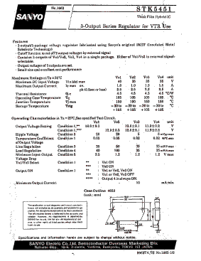

this is the only one i could find without paying. ( checks pockets ) im short on cash this week! well here ya go!

well the image you posted weren't any good cause i couldnt read it (it is too small and zooming didn't help. could you post the address of the place
