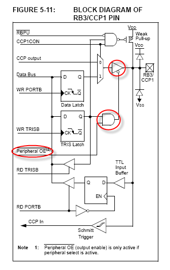

Micro 16F628 - A PWM signal used to control a DC motor, requires, when stopped, to have the PWM output pin (RB3) low.
Initially, I (wrongly) tried BCF T2CON,TMR2ON but realized that the output stays high, most of the times, so I resorted to add CLRF CCPR1L. Still the same problem :?: :!:
From the manual: The CCP1 pin is set (exception: if PWM duty cycle = 0%, the CCP1 pin will not be set)
Question a) What could be the reason I don't get that result?
Later, with CLRF CCP1CON i've got the output becoming low.
Question b) Is there a simpler way than CLRF CCP1CON to stop the PWM with output pin low?
To restart I have to set it up again as PWM (could I avoid this?) and then, if needed, to reload b4:b5 with the LSB of the duty cycle value. I feel that changing the setting of a peripheric to stop it, is not correct (or at least, excessive!!)

Immediate stop
What I want is to stop, "right now" (that's why the first option - stopping TMR2 - doesn't work most of the times because my duty cycle is 80% of the period).
Should be a simpler way... :cry:
Why don't you just set TRISB,3 bit to make that pin an input? That would definitelly stop your motor (without affecting PWM settings).

Say he sets the TRISB bit to 1, since the latch is shared between the I/O pin and the PWM, would he need to make sure the PORTB bit is set to 0 to avoid sinking current? Or is the I/O automatically blocked when you are using PWM? It's not clear from the datasheet.
That might be a problem, on the picture we see that output buffer is activated when there is a LOG0 on it's Enable input, and the AND gate that controlls it.
Ahh, I had missed a part of it when first checking the datasheet. OE didn't ring a bell at all. It's all in the note though. Somehow it's pretty obvious now with the red circle around the AND gate :lol:
So it looks like simply setting the TRISB bit as 1 would work, and making sure the OE bit is cleared would avoid problems...

Problem solved
Thanks to you all for replying.
Found the reason of the problem: I was stopping TMR2, what I shouldn't. :cry: CCPR1L was properly cleared but counting was already disabled.
Now I can say: Joel, take notes, the right way to get the output low is making CCPR1L and CCP1CON b5:b4 = 0.
In my case, CCP1CON b5:b4 are always =0 so CLRF CCPR1L is enough.
Once I write the new duty cycle value, other than 0, the output pin goes high.
