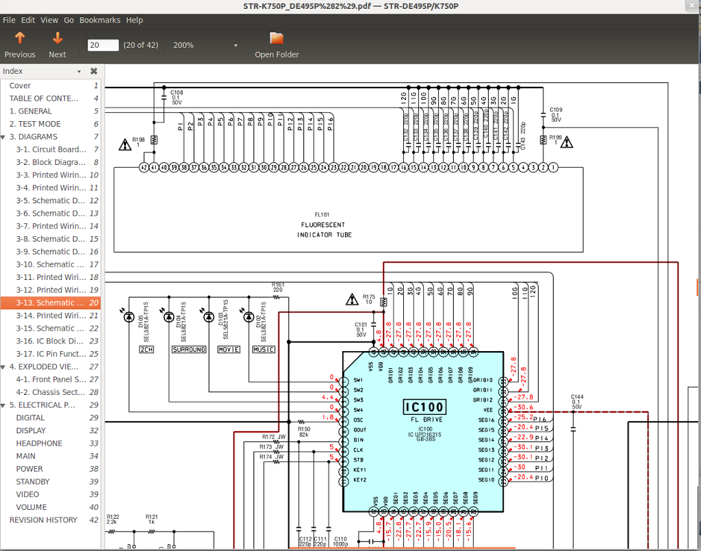

i am looking for a display switch board. the display has an led which is partly malfunctioning, it lights up led blocks when it should not, like all the time on the display ends.
supposedly x49551711 is the part number
Here is the Service Manual
  • STR-K750P_DE495P%282%29.pdf
If anyone is still interested, the problem is IC100, the square chip that drives the display.

Using a solder pencil, I resoldered IC101 and the fluorescent display connections.
I saw NO visible problems with IC100.
Ever hear of tin whiskers? might be.
If tin whiskers would a brush work, or could you use an acid to dissolve whiskers around that chip?
chip is this
UPD16315GB-3BS Manu:NEC Encapsulation:QFP,1/4- to 1/12-DUTY FIPVFD
