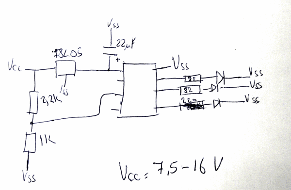

I've designed and (alegedly) built a pic (12F615) based battery monitor circuit for car/bike/you name it lead acid battery. I'm using the ADC converter to convert the battery's voltage (also the supply power) to a 10 bit binary number with which the program determines which leds light,
I've used a 2.2+1 K potential devider to convert the 0-16 volt range to 0-5 volt range but i have a small problem, I'm only getting 0.1 volt from this when powering the circuit from 12 volts and i should be getting about 3.75 volts, whats going on ???
strange thing is i had this working on a breadbord with a 10 K pot !!! (well i have changed from ADC input 0 to 3) perhaps I got some register setting wrong ? it did behave eratically on the pot after that but i think the pot is brocken....
ah ! haven't got one, as for the pic input and the resistors its simple, 2.2 K from Vcc to pin 3 of 12F615, 1 K from GND to pin 3 of 12F615, i'm gettng 0.1 v instead of 3.75volts on pin 3 of the 12F615

I' try and get a scematic up later but it does not really help in this issue, I think i know what I built, I'll have a thorough read of the datasheet today see if I can spot anything
schematic attached. according to the data sheet the AN3/GP4 pin is input only.... I'll have to look at all other functions
could it be that the "weak pull ups" need disabling ? that might account for this going haywire, its the WPU register

its very odd i just half plugged the pic into the circuit and the orange light came on which is correct, at another time thought the Vdd was 1 V !! this is very odd, i have examined the board with a magnifying glass and can't see any trace of short circuit
Take a look at this line of code:
TRISIO  = %00001000                 ' set GP4 as input GP0,1,3 as output
If trying to set GP4 (i.e AN3) as input, GP3 is always 1, TRISIO should be:
TRISIO  = %00011000                 ' set GP3,4 as input GP0,1,2 as output
hm you have a point, so you say I'm confusing AN3 with GPIO3 ? sounds like the answer, adding to that that bit "0" is the first digit I'm just not seeing it am I... I'll try it and let ya know
Your perfectly right nick thank you so much its such a silly mistake but its an easy one to make (well thats my exscuse :D)
