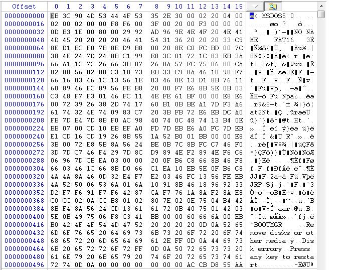

Dear All,
I have pretty much finished my SD Routines and have started testing them with a collection of SD cards I have accumulated.
I have had positive results with 128MB, 256MB and 1GB cards - no problem.
I am left with a 512mb and 1GB card which is giving me some odd results.
Take a look at the MBR output produced from my code.

It looks "like" an MBR as it has the 0x55AA at the end of the block and also bytes 0x1C0-0x1CC look like valid data for the first partition.
The strangeness is where all these 0x0f and 0x04's come from. I wouldnt mind so much apart from the fact that it takes the 0x0F04 and OR's it with the actual data on the sector.
Does anyone know why this happens?

I wish that was true, I have found the boot sector and the output from my code throws this up.
0xEF 0x04 0x90 0x4D 0x53 0x44 0x4F 0x53 0x3F 0x04 0x30 0x00 0x02 0x20 0x04 0x00

0x7F 0x04 0x0D 0x0A 0x00 0x00 0x00 0x00 0x0F 0x04 0x00 0xAC 0xCB 0xD8 0x55 0xAA
Every 1st and 2nd byte of an 8 byte group has a 0x0F and 0x04 through it.
Looking at the boot sector from WinHex (I'm getting better at using this) doesn't reveal any of these.
Bizarre! any suggestions would be welcome.
Regards
Mark
