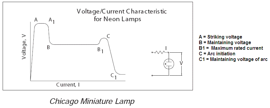

I'm thinking the problem lies in my neon bulb. I had to use a really small neon bulb, I had a bigger one but one of the leads broke off. So I figure since the neon is tiny, the voltage is high enough to jump the gap reall easily so no chage builds up in my .56uF cap.

The size of a neon bulb doesn't make much difference, it still requires a similar voltage to fire - bearing in mind it can vary over a fairly wide range - something like 60V to 90V?.
So I doubt that's your problem?.

I know the xenon tube, I was referring to the neon bulb used to trigger the SCR.

That odd circuit doesn't have a current-limiting resistor for the neon bulb. It must have a very high-current arc inside instead of a controlled normal glow which could damage it and wastes power from the timing cap. The neon bulb's arc might rob the SCR from enough voltage across its terminals to turn on. Look at the voltage/current curve of a typical neon bulb:
