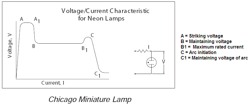

Neon bulbs always have a current-limiting resistor. They have a voltage regulator effect like a zener diode or LED. Have you ever tried it with them?
As the voltage of the AC mains sine-wave increases, also does the current until a certain current is reached when the neon bulb arcs, dropping the voltage drop and increasing the current without limit.

With 120VAC a low brightness NE-2 neon bulb uses a 220K series resistor for 25K hours life. A high brightness NE-2H bulb uses a 30K series resistor for the same life.
It is difficult to calculate their current because they are off for each half-cycle until the voltage rises to their striking voltage of 65V to 90V.

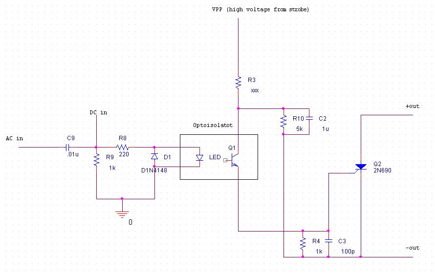

I'm working on making it so that I can control my strobe with a 555 timer. this is the schematic I'm going to use for the optoisolation.
What kind of voltage rating do I need on my optoisolator?
