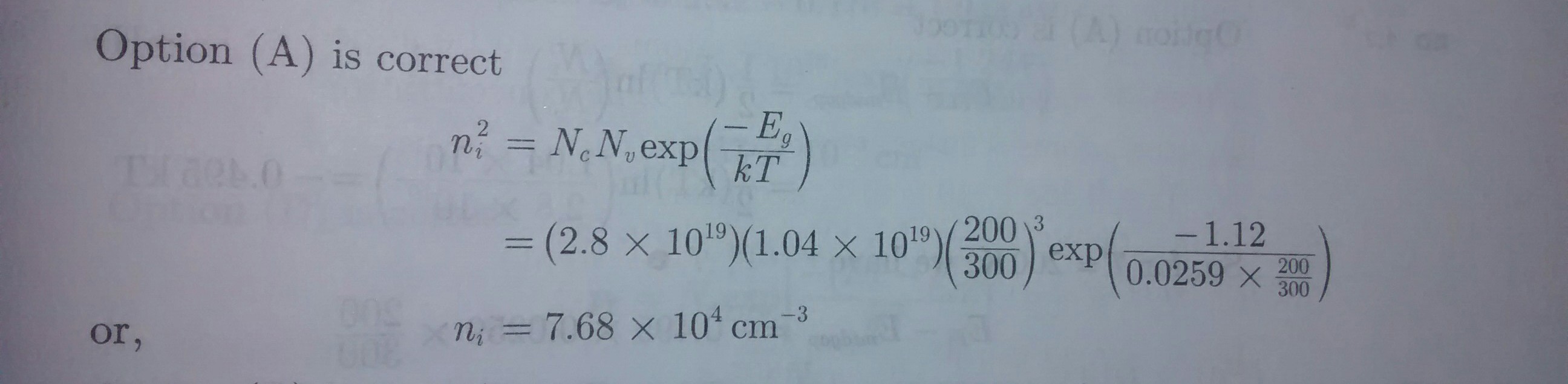

question : find intrinsic carrier concentration at T=200k for silicon (in cm^-3).
Answer is attached.In that why is that (200/300)^3 is added there.my only hope is this forum.Thank you
