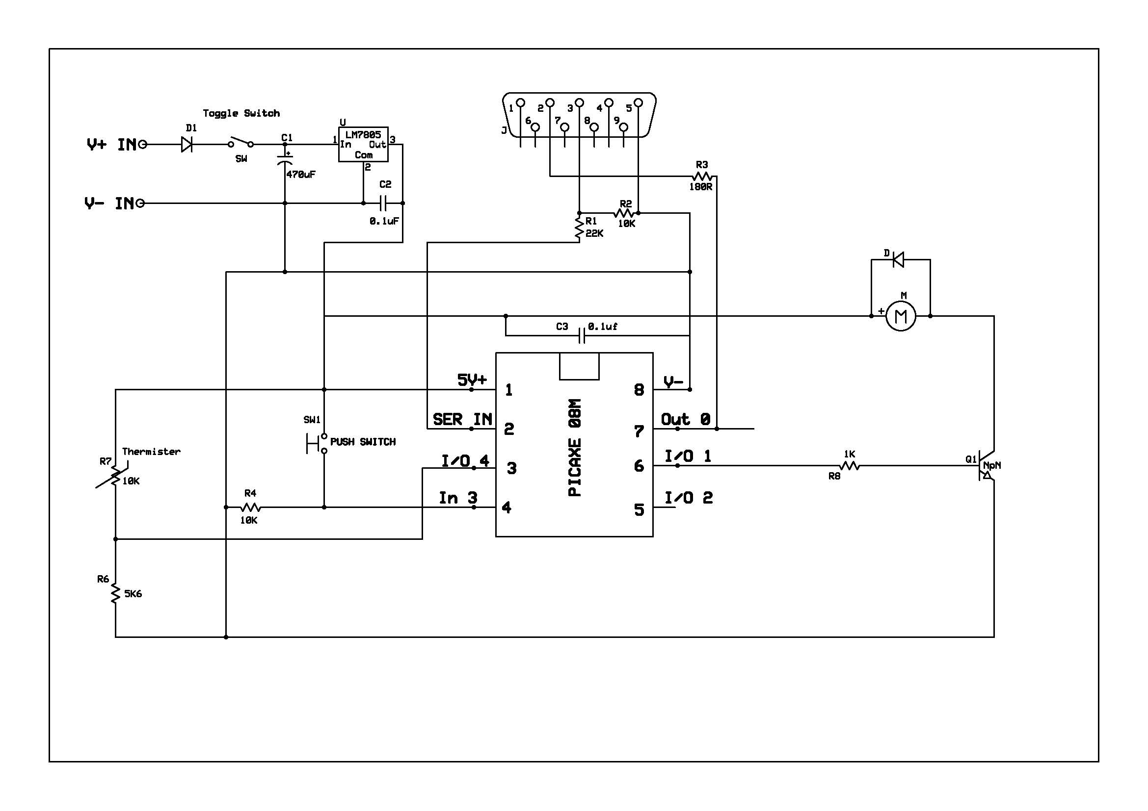

Ok, Sorry about all this confusion guys. I was just a little frustrated when I posted this!
Anyway, the circuit diagram is attached to this post now.
I have programmed the chip in the following way:
main:
if input4 = 1 AND input3 = 0 then wait 12 high output0 ;gas and switch ON, wait 12s and Motor ON
endif
if input4 = 0 OR input3 = 1 then low output0 ; gas OR switch OFF, Motor OFF - if the flame is on in the middle
endif
goto main
The whole idea is simply trying to make sure that gas is not leaking from my gas cooker at home. When the thermistor's resistance increases it means the flame is now on and thus the motor turning the nob on the cooker is OFF. When there is no flame (i.e. gas is leaking) the motor is will turn ON, turning the nob which turns OFF the gas.
The switch in the circuit diagram should in reality be replaced by a contact in the nob, so as it turns around it will touch the contact, turning the motor OFF. The reason I chose the 12s wait is because it takes around 10s for the thermistor's resistance to reach about 5k which will turn off the motor. If after that time, the resistance is still 10k then there is definitely no flame and thus the motor should be ON.
Hope this explain more clearly what I am doing.
Now for the problems that I have.
1. My PIC seems to go ON and OFF about 6 times as soon as I turn it on even when I have a 0.1uF decoupling capacitor between the two power pins. This only happens as I supply power to the circuit, but after that it does seem to behave fine. By this I mean I can turn the switch ON and it will react as expected, I turn it OFF and again it reacts as expected. But I always have to initially wait a while before it settles when I power the circuit for the first time. This happens regardless whether I connect the motor to the circuit or not. It will behave like this even when I connect it by itself to my test bed (also attached).

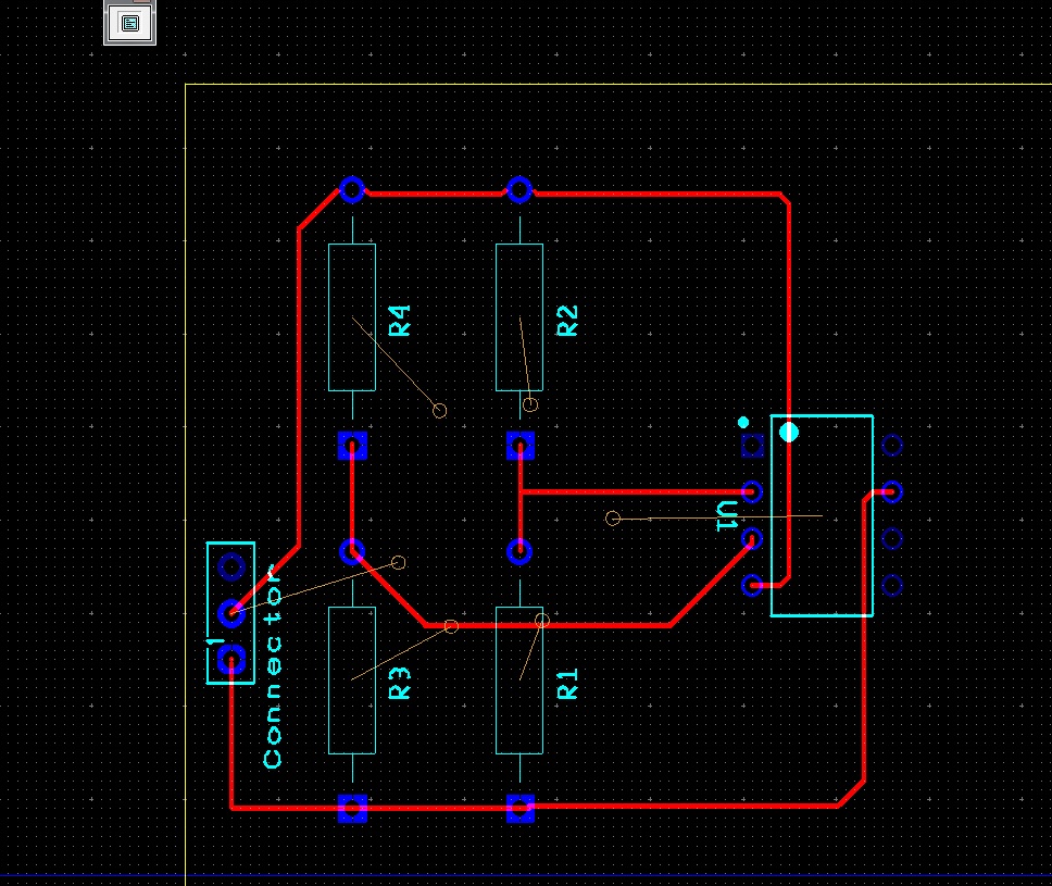

2. I accepted the problem with the PIC and tried to solder the whole circuit from my breadboard into my copper board, using jumper wires. This failed as I tried to make a "bridge" with my connections as I can only connect jumper wire to each pin. While soldering I accidentally connected the wrong pins together (since they are pretty close to each other and I am not good at soldering yet). I then tried to fix this by de-soldering the connections, but I don't have a de-soldering braid and so I messed the connections up pretty badly. After trying to fix it as best as I could I then tested it and of course it didn't work as expected.
3. I am now trying to create a proper PCB by using Multisim/Ultiboard software to simulate the circuit and then produce the PCB. The problem here is that Multisim does not have the PIC that I am using (it only has PIC18F84 and PIC16F84A) but I was able to at least simulate and create half the circuit (attached). I could just add a DIP8 package from Ultiboard which would work. Though I keep getting DRC errors saying "Unused Pin Connected to Copper". I can't find any good tutorials online so I don't quite know how to use Ultiboard yet.
I think the best way to fix the issue's with the PIC and the PCB stuff is to create a PCB design on Ultiboard and then produce the PCB. That way noise might not be a problem as I am not using any long wires then, I am connecting the circuit directly to batteries and by adding a 0.1uF capacitor between the pins of the chip it should work ok. It will also be easier to solder that way and I don't think I will make many mistakes (plus I will get practice making PCB's).
What do you guys think?
Fouad.

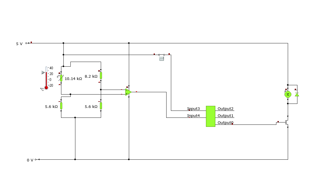

First try the following code:
main:
	If pin4 = 1 And pin3 = 0 Then MotorOn
	If pin4 = 0 Or pin3 = 1 Then MotorOff
	goto main
MotorOn:
	wait 12 'Wait 12 Seconds
	high 2 'Motor On
	pause 500
	DO: LOOP Until pin4 = 0 Or Pin3 = 1
	goto main
MotorOff:
	wait 1 'Wait 1 second
	low 2 'Motor Off
	pause 500
	Do: Loop Until pin4 = 1 And pin3 = 0
	goto main
I changed the pinout and pins used from what you had. The code runs fine in simulation and I actually loaded it on a PICAXE 08M to test it. This should give the results you want. Try to keep the code broken down and structured as above.
I did not overly look at your circuit and you did not identify the opamp used?
I have no idea as to the chip cycling at start up? Never had one do that. I use a tiny little board I made up to run and program the little 08M chips that I dug out. Anyway, the above code works so just copy and paste into the PICAXE Programming Editor and play around with it. It should get you started.
Ron
Ron
ah thanks! I shall try that now. Also the opamp used is an LM741CN
YES!!! It does indeed work! But I dont understand why my code doesnt work. Actually, when I change your code and put the output as output 0 then it does not work and behaves exactly like mine. Now when I used my own code and replaced the output0 with output2 then it works as expected (takes about 30s to start for some reason, but im sure thats due to my code)
The code I used is shown below:
main:
if input4 = 1 AND input3 = 0 then wait 12 high output2 ;gas and switch ON, wait 12s and Motor ON
endif
if input4 = 0 OR input3 = 1 then low output2 ; gas OR switch OFF, Motor OFF - if the flame is on in the middle
endif
goto main
I do wonder why a change of output will change the behaviour so much...
As to the code I'll look more at it later. At work now. :)
There are several ways to code things to get what you want.
I would drop the LM741 and use a LM311 as what you really want is a comparator circuit. The LM311 is more suited to what you want, works fine off a single rail and works on 5 volts.
Ron

For starters with this circuit i would loose the opamp as it is not needed, as the picaxe can do all the work, what we do is read the thermister with an ADC pin...........simple.
For example.

Here is a basic schematic, i revamped an existing one and left the voltage regulator in the schematic but it is not needed if your battery is under 5 volts.
Try not to use output 0 for your motor as it will do some weird things when you try to download a program to the picaxe.
I think the reason why your chip cycles on power up is you have not got the 22K and 10K resistors in the circuit that are needed in the download circuit, they MUST be in the circuit at all times.
I was not sure what you had connected to input3 in your drawing so added a push switch in there at a guess, also if it was a switch the pulldown resistor was missing (i added a 10K)
What you will need to do is setup this little circuit as i have drawn and run a little test program, so as to show the value of the thermister on screen using "debug" this way you will be able to see the ADC value change as the thermister warms up and to be able to determine what value we need to write into program, as the switch on and off points for the motor.
Here is the test program.

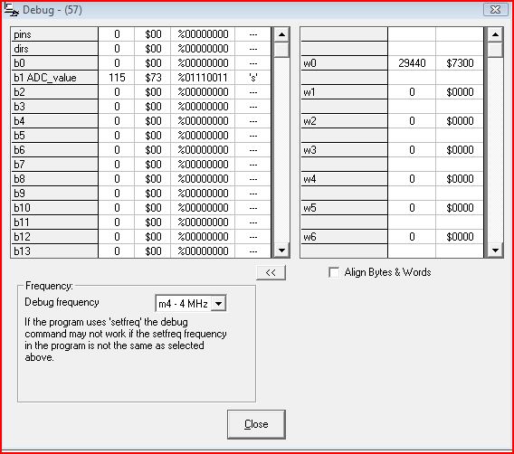

I have added a screen shot of the debug window should you have not seen it before, and as you can see variable B1 is called ADC_value, the number next to it will change as the thermister warms and cools, it is this number we need to know, to when to turn the motor on and off.

On further thought of what you are doing or trying to do i am a little confused about the motor operation
Now what turns the knob on in the first place?
Is the motor turning the knob on and off?
If so, then there is a need to forward and reverse drive the motor, which will need a relay or H bridge of some description to reverse the polarity to the motor.
If all the circuit is to do, is turn the Knob off in the absent of a flame, then the circuit will work as designed, but how do you turn the Knob on with a motor attached to it.
It would be much easier to use a solenoid to switch the gas flow on/off prior to the knob.
Although a solenoid would not be good to run from batteries.
Pete.
