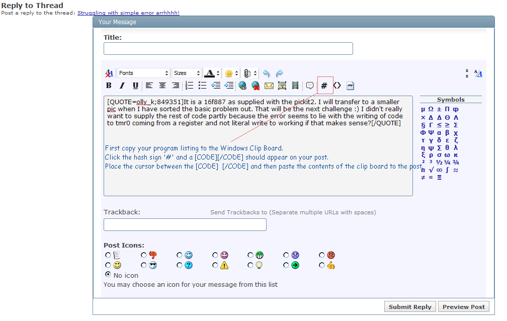

To be fair I cannot find a code button anywhere but have amended things manually now so hope that makes things a little easier...
regards the code button when I go to advanced mode I get no options at all!

Look at this image.

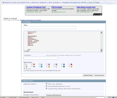

**BTW this is what my screen looks like!
