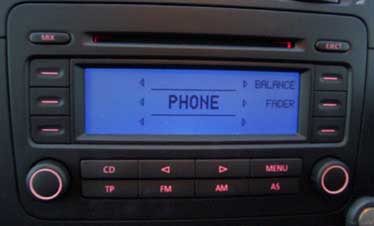

Its a factory fitted 10 speaker system (three in each front door & two in both back doors) plus the subwoofer . I've got a VW Golf with the original head unit - its an oversized one like in Ford cars - I believe it is made by Blaupunkt. There weren't any outputs for the Sub, however I spliced some wires off of the ones coming out of the headunit (L+R from both rear speakers), and fed them into the Amp, which has 4 speaker level inputs. I'm after getting the imaging right, less interested in volume.

The headunit isn't designed for a sub so maybe it cuts out the deep lows.

I still think that your headunit rolls-off the very low frequencies that cannot be produced by "ordinary" car speakers and that might even damage them.
