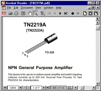

2219 ?
thats to drive the 3055, yes ?
just looks like a small npn to me,
nothing special,
gain is pretty immaterial,
40 volt max,
half amp max,
i think anything close would do,
try to pick one with the same pin-outs ....
Best of luck with it, John :)
