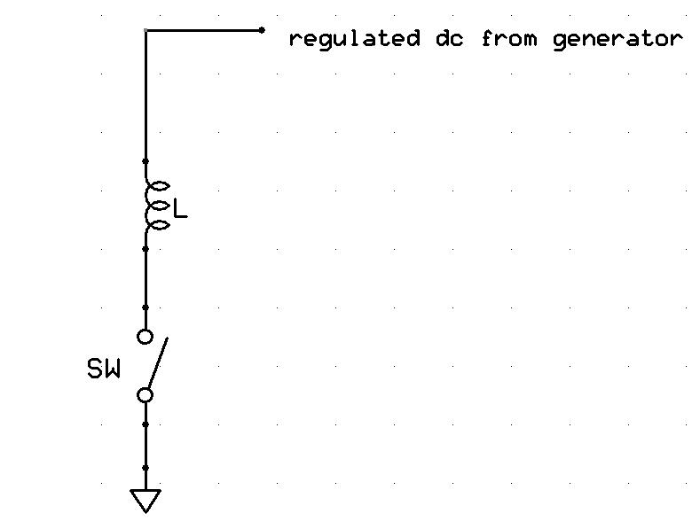

I have got a circuit with a mechanical relay. The mechanical relay used is a normally closed one. The problem is that I need to replace the relay with a some solid state device which behaves very much similar to this mechanical relay. That is, even when the circuit is not powered by any supply, since the mechanical relay is a normally closed one, the solid state device should act as a normally closed one. for example, consider a p channel mosfet. The mosfet is a normally closed one if Vgs=0 and when there is some Vds. In my case I need a solid state device which acts as normally closed even with no Vds and no Vgs

How is the present relay being controlled in the existing circuit.?
hai i have uploaded a jpg image showing the position of the relay. The application is actually the field coil of a generator. The relay is shown as a switch in the diagram and the field coil is shown as an inductor. As the rotor rotates the generator produces a small voltage due to residual magnetism in the field which is regulated and supplied to field coil and thus the magnetism is strengthened and in this way the generator produces its rated current and voltage. for this process to work the relay must be short circuited so that the field coil is connected to ground for free flow of current. Mechanical relay is used for this purpose, but now a solid state device is needed. I need to find a solution
Digikey depletion mode mosfets: https://www.digikey.com/product-sea...ee=0&rohs=0&quantity=&ptm=0&fid=0&pageSize=25
Digikey isoPower driver: https://www.digikey.com/product-search/en?x=-1147&y=-71&lang=en&site=us&KeyWords=adum5240
Datasheet for first 200V/16A fet in list: https://www.electro-tech-online.com/custompdfs/2013/05/DS100260AIXTH-T16N20D2.pdf
If you use both channels of the isoPower IC to drive the gate-source, you can have +/-5V to control the gate. This means 1 Gigaohm in the off position, 40 milliohms in the on position, and <1ohm when unpowered (these are rough estimates based on Fig 2 of the datasheet).
