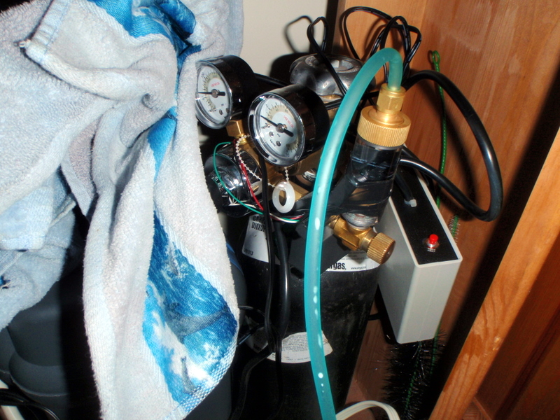

OK, just posting a little newbie excitement at making a working PIC project. Wanted to "show it off" and thank those that help folks on this forum (and acknowledge the websites like Nigel's and Spency's which have helped me immensely).

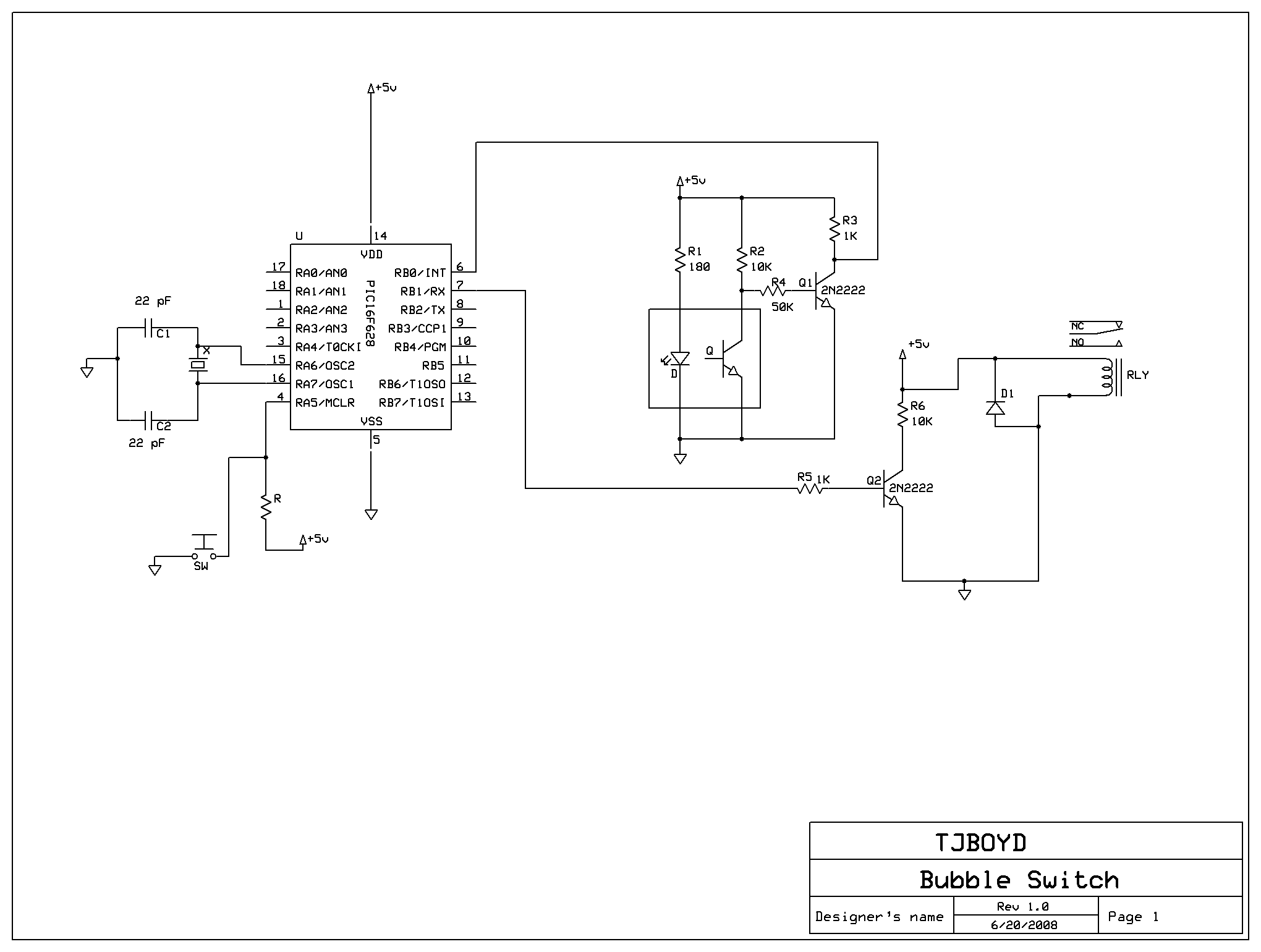

So, I decided to put a CO2 system "on" my aquarium. You could read about it here, but the long-shot is freshwater aquarium plants are limited by dissolved CO2. In the year I've had the system up and running, it's decided to go nuts - don't know if it's the regulator diaphragm (which reportedly can "buckle" and fail temporarily), or perhaps the fingers of my 3 year old boy who watches intently as I adjust the regular. Anyway, during the failures, it drops the pH significantly and all the fish turn belly-up. Very sad when they become part of the family. So, I decided to use an optical sensor to try and shut off the regulator solenoid if the bubble count got too high. I'm including the circuit and a picture of the photodiode one the bubble window... Here's the source:

So, I wanted the solenoid "off" if the power to the circuit is off just in case. So the program turns it on, waits for stabilization, then starts monitoring the bubbles per second. If over 2, it shuts down (saving the fish I hope!).
Anyway, just a thanks to everyone lurking here - without the reading material, I never could have done it!!!

Ahhh, that's gonna be the true "acid" test (OK, pun intended). We're on day 3 and all seems OK - one trip event so perhaps junior isn't the culprit after all. I did forget to give credit to someone (who I can't find now through my googling) who gave me the idea putting the photodiode on his beer fermenter airlock. That's gonna be next - it's why I had an extra CO2 tank lying around!
