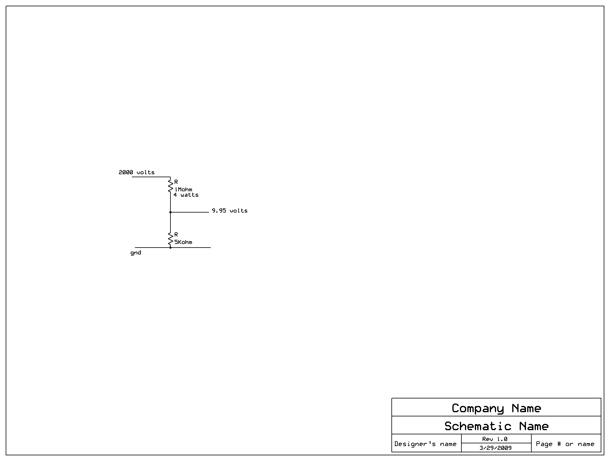

What does your voltage divider look like?
You're using 2 resistor to isolate 6 THOUSAND volts? Are they rated for that??
I think it is just rated to 6kv but not literally 6kv voltage
How can a comparator compare 5 diff values? Two analog signals must be compared first and then the higher valued signal with the next and so on...
A comparator just indicates if the input signal is higher or lower when compared to a trip point. i.e. the actual value of the input signal is not reproduced at the output... Am I right?
It's just two resistors.
