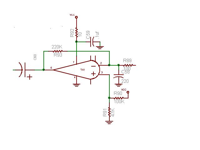

Try this:
This is a common '741 OP Amp like a LM741. Pin 3 sets your bias. The resistors are usually 50/50 like two 47K resistors. I just clipped this out of an old schematic where I needed the bias to be closer to saturation. The resistor labeled R93 is your feedback gain or just gain. I've seen resistor values as high as 1Meg which gives maximum voltage gain but loss of drive power (less current).

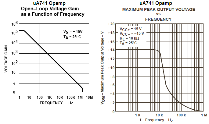

A lousy old 741 opamp has a max gain of only 4 at 200kHz and a max output of only 1.5V p-p.
