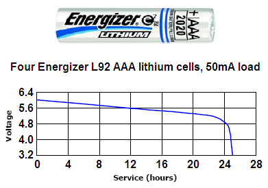

I suggest using 4 Energizer AAA lithium cells in series. With 4 cells, you won't need the DC/DC converter and could use a low-dropout regulator for the 5V for the LCD.
janetsmith2000@yahoo.com said:
But a lithium battery sounds expensive.
It is the most expensive disposable battery I have ever seen. I was lucky to get free samples. It lasts and lasts and lasts and ...
Its voltage drops much more gradually over its long life than an alkaline battery.
Think about its value. It costs about 2 or 3 times as much as the best alkaline battery but it lasts about 7 times as long. Plus you don't have to replace it as often. Its shelf life is at least 15 years!

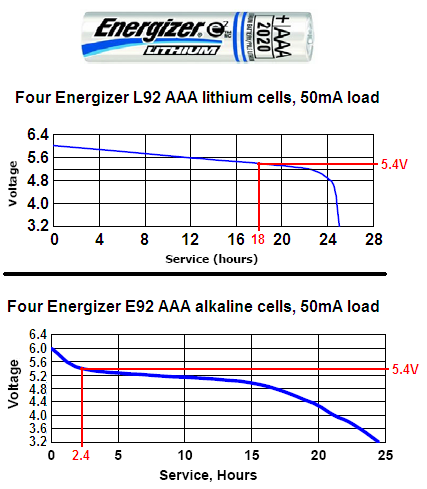

I am designing a SIM card reader. I hope 6.4V wont kill the SIM card
I think anything over about 5.4V would fry it. That's why I recommended using a low-dropout 5V regulator that would still regulate when the battery voltage drops to about 5.4V.
