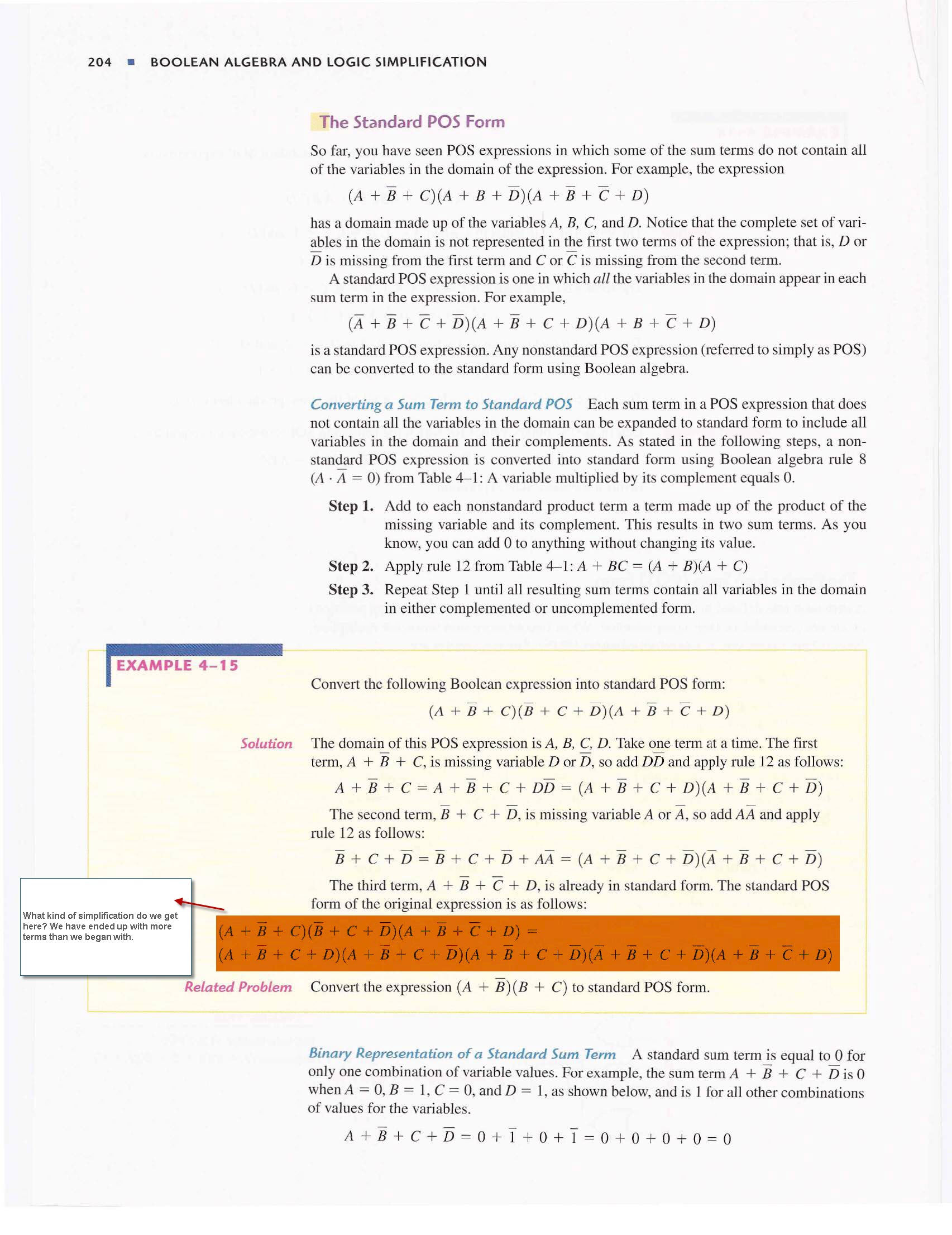

Q1: It is said that these standard forms are simplified expressions. Please have a look on this attached page and please tell me what makes it simplified version. Thanks.

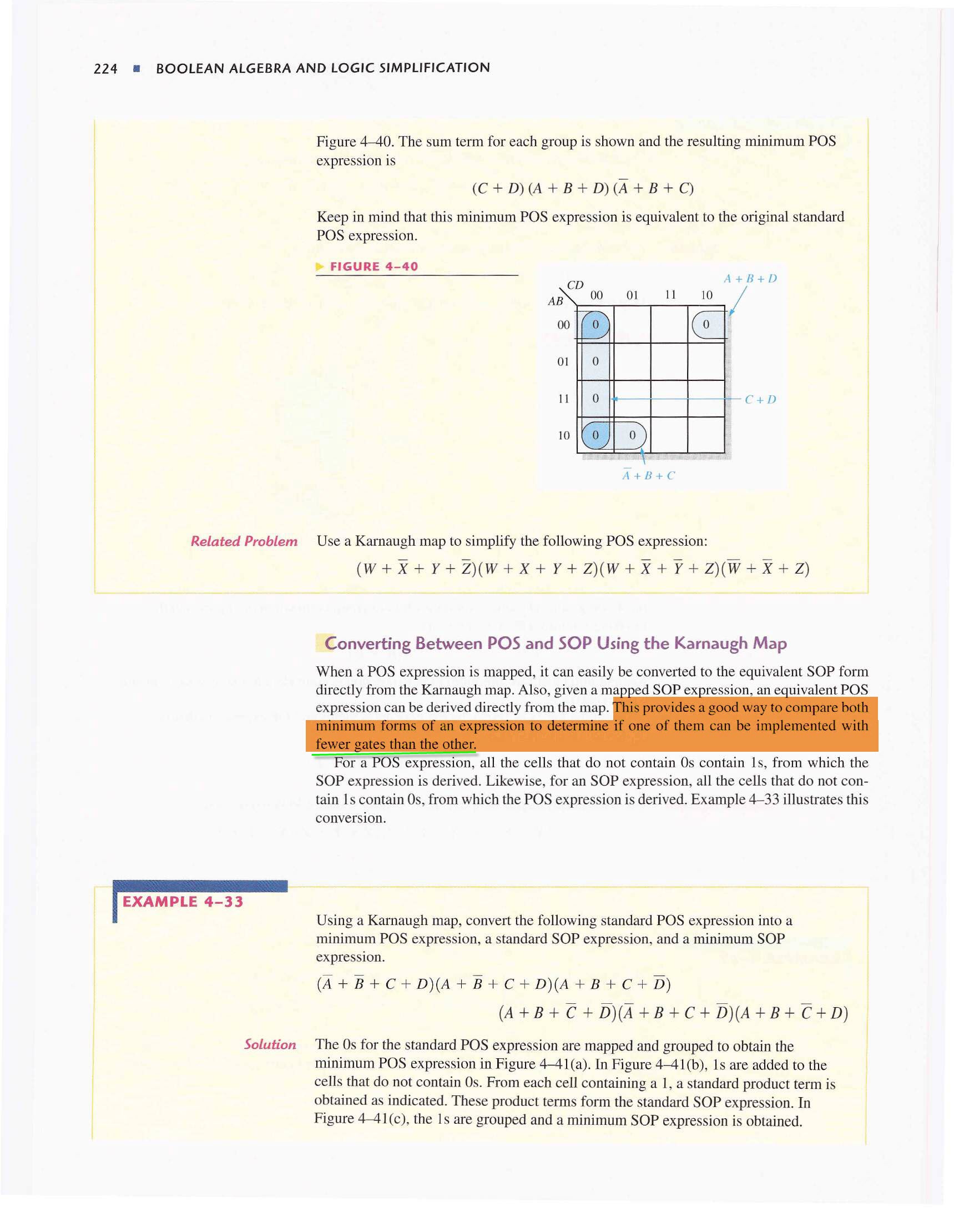

Q3: It seems there are very strong relationship between SOP and POS. Please have a look here.
Q4: Please have a look here.

SIMPLIFICATION VS EXPANSION
Sometimes you simplify and sometimes you expand. When you expand it sometimes leads to more simplifications later or another way to solve something.
