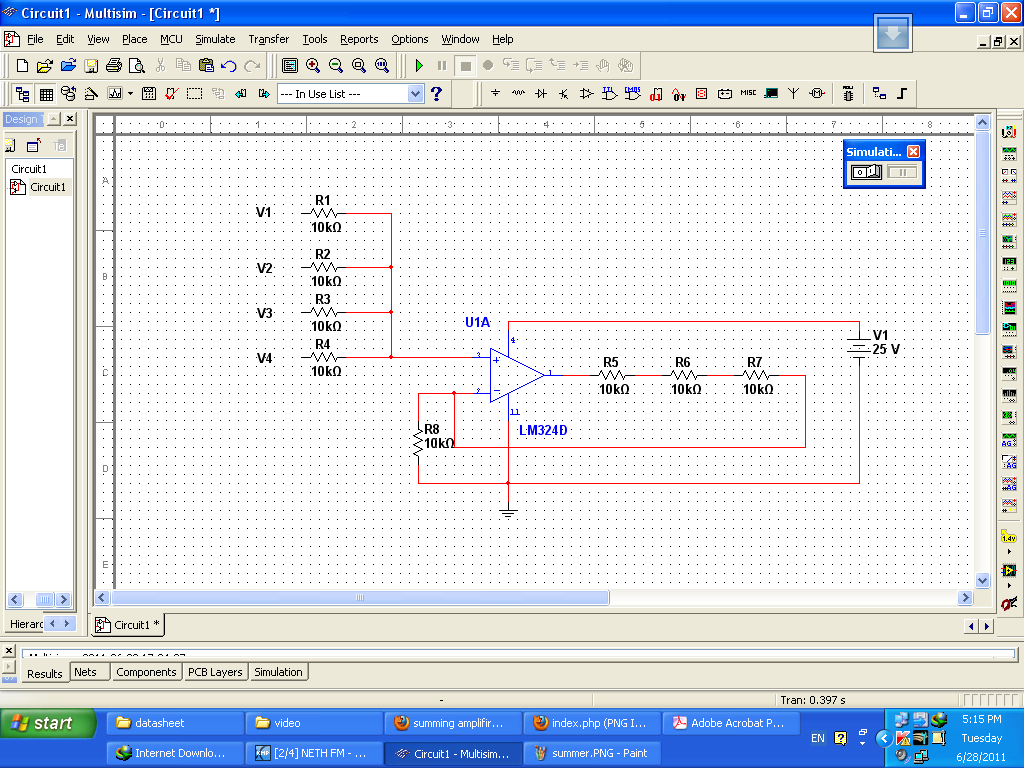

I'm making a non inverting summing amplifier using LM324. I will be adding 5V inputs (supplied using micro controller pins to get voltages 5,10,15,20 from summer) since all the resistor values are equal, is there any procedure to select a proper resistor value ? see the attachment

I must say, I don't like that as a circuit, and probably wouldn't consider using it. I'd either use a pair of opamps, one as a proper virtual earth mixer, the second as an inverter - or (most likely) use a single opamp as a virtual earth mixer and do the inverting in the software.

Basically for the non invert, make the gain equal to the number of inputs and keep all the input resistors the same, if all the input voltages are the same.

Ya I know this, thats why I used 3 10k resistors to set gain. 4 inputs so gain is four (3+1). my question is what is the proper resistor value? is 10k resistors are ok or should i use all 1k resistors or any other resistor value?

As its a PIC with a low output impedance output, I would have chosen 2.2K thru 10K.
How fast are the pins being switched.?
EDIT:
Ideally the driving source impedance should be close to zero to give the best summing accuracy.

A proper summer uses inverting mode, as this gives a virtual earth and hence no interaction between the inputs.
Although as you're simply switching logic levels, it's not so much of a problem.

The NI summing OPA amplifier as posted by the OP is standard practice and in common use.
It requires only one OPA, a single supply rail and common same value resistors on the inputs.

Its a simple high/low input from 4 output pins on a PIC, say an ideal swing of 0V to +5V.
And as a NI summer only requires only one supply voltage, I fail to see how it can best determined by other things in the system.??
IMHO the solution the OP has posted for his application, is the only logical choice.
