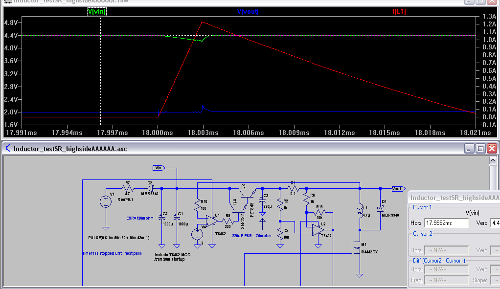

Heres my LTspice circuit, I haven't included the controller part, because that is just a mess of logic and comparators to emulate my AVR software :)
Am I going about this the right way? It looks deceptively simple to me, even if it is rather senstive to the outpu caps value and ESR.

I think you are doing very well with your spice circuit, however the model is missing something. The series inductance that would appear in series with the output and possibly in series with the capacitor after the pass transistor and possibly in series with the input caps before the transistor, and possibly between the power itself and the filter caps. At the very least, some small inductance on the output to simulate real life wiring.
The LM358 would never work for this app so it's a good idea that you went to a better op amp.
Also, the 'sense' lead (that going to the small resistor R10) is best done with a separate lead to the DUT, and same with the ground lead from the reference voltage V4. Those two leads would be brought out separately from the power leads so that they make contact with the actual DUT lead connection points. That means that the sense voltage is actually the voltage across the inductor and not the voltage across the output of the regulator. Since this might not work too well with the ground lead, you'll have to make sure that the ground lead to the ref voltage source V4 is connected directly to the common for the MOSFET. You'll have to compensate for the MOSFET losses too. If the inductor can be connected directly to the test set, the sense line might be ok connected to the very output terminal of the positive output lead. That way it makes up for some of the inductance in the circuit as well as resistance.
If there happens to be too much oscillation sometimes a small series resistance can dampen that out.
To make the response faster, sometimes derivative feedback is used. This technique falls under the general category of "state variable feedback". This kind of feedback makes predictions about the future output based on the slope of the output, and because of this it can provide additional feedback information to tell the circuit to drive the output harder than it normally would to help make up for the sloping output as you noted with a quick inductive connection. This would involve measuring the slope of the output and combining that with the normal feedback and adjusting the level so that it doesnt oscillate but does compensate somewhat for the normal slope. The result is less slope than without it. The derivation is mathematical, but unfortunately it requires a lot of exacting knowledge of the circuit components and in this case the little inductance here and there which is hard to nail down, so an adjustable network would probably be best so it can be fine tuned to fit the stray component values. You may not need this, but something to keep in mind.

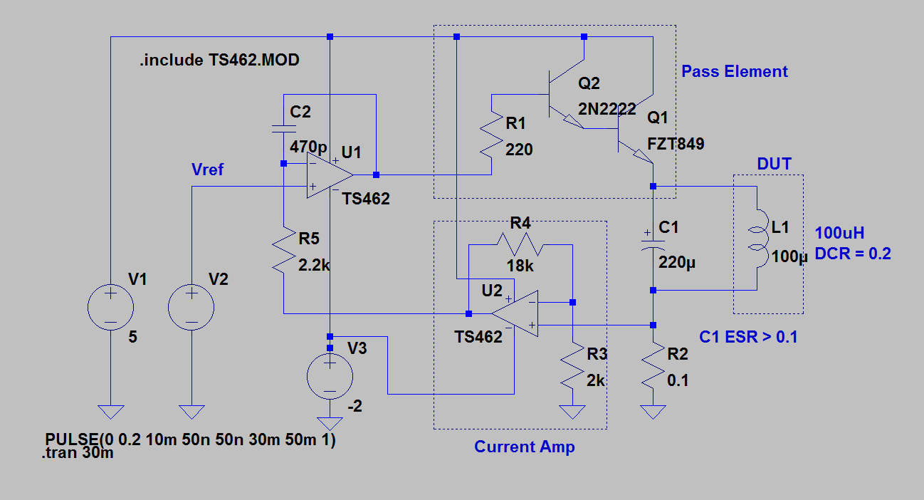

A quick run down of what I want to acheieve:
A opamp/transistor based circuit, with a Vref input, a Iout signal (low side 0.1ohm current sense resistor, with fast opamp x10 gain), and I set, with Vout. Also, a logic line I can use to select between the two.
So, when the logc input is say... 1, the circuit regulates the voltage to whatever is on Vref (no gain, 1:1 ratio). This must have a fast transient response. Iout can then be used to see the current flowing to the load (which is an inductor, so it'll be a ramp)
But when the logic level is low, the circuit should regulate current, albe it quite a low current, between 50 and 200mA. I will then need a differential amp to measure the voltage across the load - or just subtract the current x sense resistor.
Note, as I said before, this isn't strictly a CC/CV supply, as there shouldn't be a current limit in voltage regulation mode, I'm just measuring. And these will not be used at the same time, just wanted to see if I can get away with using the same
opamp circuit and pass transistor(s) for it :D
That all seems complicated, so here's a schematic, thats worth a thousand words.
Note, I found that putting the output cap (C1) across the load, rather than just the output to ground a lot more stable for sensible ESR's. In voltage regulation mode,
this voltage should remain the same anyway. R5 and C2 are my half hearted attempt to slow things down, without slowing it too much. In voltage regulation, the output of the curernt amp won't be used... instead a differential amp measuring the voltage across the DUT will be used. I'm kind of at a loss here...
Hello again,
It's been so long i am not entirely sure of what you are trying to do here.
Are you saying that you want to regulate the output voltage instead of current regulation, and want to be able to switch between these two modes, and use a differential amp on the output to measure the voltage and provide feedback? If so that probably isnt too hard to do, but you cant really regulate the DC voltage across a power inductor because the inductor response will only be a DC current which will be very large unless the DC voltage is very small. With 10 volts and 0.1 ohm series resistance in the inductor the current would be 100 amps for example. But maybe that's not what you want to do, so let me know.

Ok, you've pretty much understood exactly what I'm trying to design, amazing considering I'm not great at explaining things! So, I'm measuring inductors using a 'splat test'. Using a constant voltage, switching an inductor with a MOSFET across it, and measuring the ramp. I'm fairly certain I have the measurement part down (timing between two current thresholds). Because I want as much time as I can get to get the best resolution even with <4.7uH inductors, I'm using a low voltage, 1V or 2V, to slow down the ramping current. Also, simple values like this make for easier calculation. Once a certain current has been reached, the MOSFET will turn off, and for a 100uH induct, with 1V supply, and a threshold of say, 3A. That's 300uS. Larger inductors will be sensed with a timeout, and the current threshold lowered so that I'm not trying regulating the voltage when serious amperage flows, for any length of time.
Now, so far thats just a fairly simple 'voltage regulator'. Built with opamps and transistors to avoid off-the-shelf devices' current limit. I know there are 10A linear regulators out there, but I fear they either won't have the response times needed, or have special requirements.
The reason I want to be able to change this into current regulation is to measure the inductors resistance. This time, response time isn't needed, I'm putting a small current through both the inductor and the switch, and measuring the voltage across it.
This gives a small voltage drop (probably won't be able to get <10mOhm resolution though) and so, knowing the set current can work out the resistance of the inductor and MOSFET. Using a known resistor in place of the inductor, this can zero-out the MOSFET's resistance. Resistance is important because this affects the current ramp when measuring inductance, plus its also a handy thing to have on an L meter :)
I guess, my problem is, not actually designing a voltage regulator, or a current regulator, but finding a way of both being able to use the pass transistor, at different times. So far, all I am doing is changing the negative input of the regulators opamp from a measured voltage (differential amp and subtracts the current sense voltage from the regulators output voltage), to a voltage that represents the current. These require very different control loops, essentially fast and slow. I'm not really after speed when measuring inductor resistance, there will be some ringing, so I can just wait for this to settle before taking measurements, but the voltage regulation mode should be stable.
I'm venturing into bode plots here... somethign I do not fully understand but have many app notes to help me (and LTspice). But perhaps I could just use two different opamps? and switch between the two somehow? (current steering diodes maybe?).
Once again, I do tend to waffle, and whilst its not horrifically complicated, its not easy to explain clearly, so here is what I have so far. The previous schematic was a simple 'current regulator' using the low-side current sense setup I have. Very crude loop network to slow things down, but it works reasonably well in simulation. Here's the schematic of the main design, this time in 'voltage regulation mode'... with very little compensation:
Apologies its not pretty. I can't seem to make 'nice looking schems' on LTspice.

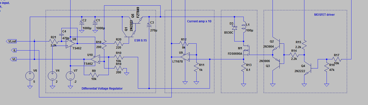

A switch (be it digital, or analogue, controlled by a microcontroller, ) would be a convenient way, however, the Vref and Iref (max voltage and max current) are set by a 12-bit DAC, so of course these can be set to maximum, or minimum in order to turn on/off each part of regulation. So yes, in this way a CC/CV supply would be fine. You rightly pointed out the issue of setting the voltage part 'low' during current regulation, because as I'll be testing power inductors (perhaps up to Irms > 8A) their resistance will be super low. Although I realize that a really fine resolution for resistance is not easy, say if an inductor has DCR of 12mOhms, a 12-bit DAC (Vref 4.096) would give an ideal resolution of 1mv. So a current of 1Amp through that inductor, would only give 12mV which is so tiny to set, even a rail-to-rail DAC would struggle to keep that close to the ground rail (although the DAC would be connected directly to an opamp's input, high impedance). Perhaps I could use a small signal mosfet to pull the input to the opamp pretty much down to ground, even when the DAC outputs '0'. A series 10k resistance from the DAC and a 2n7000 would nail that.
I considered using analogue switches to change both the input to the opamp feedback (a voltage representing output voltage, or output current) ... AND... switching the compensation. So I can have a very fast transient response for voltage regulation, and a slow one for current - to reduce ringing when switching in a relatively high value inductor. However, I'm cautious about inserting switches into feedback loops. If the output voltage goes up to max (say, 4V), I will not have much of a load on it without the inductor switched in.. so it will take a while to discharge the output cap.
As I was googling for ways to have 'separate control loops' controlling the same pass element, I came across this wonderful project:
He chose the second method, with one control loop, it seems he was after perfecting the transition between CV and CC - something which I do not need, as they will be completely separate tests. So the top schematic would be ideal. There are however differences between that and what I'm doing.
Firstly, He is using a MOSFET pass element, I'll be using a darlington (a high current, high gain main NPN, driven by a smaller NPN, Perhaps FZT1051A - 40v, 10A peak I, with a 2n222A).
So thats current driven, as opposed to voltage driven.
Secondly, he is using high-side current sensing. I looked into this, as it is generally preferential in all situations, (making load voltage measurements much easier) but had trouble deciding on a high-side monitor that was fast enough, as well as kept errors low even with small sense voltages (accurate at say 5A, but 20% error at 50mA). I have some MAX4172's somewhere, which dont' seem to be used as much as the MAX4173, but gain can be adjusted and appears to be fairly accurate. Only 800kHz bandwidth, at full scale range, which could be difficult for fast current ramps with low value (<4.7uH) inductors.
https://datasheets.maximintegrated.com/en/ds/MAX4172.pdf
I only have the LTspice model for the MAX4173T which seems both very accurate, and fast enough - that however, has double the bandwidth of the 4172.
I chose a low side measurement, because, despite the real hassle of using a differential amp to measure voltage across a load, it is straightforward, can be very accurate, and I can choose a high speed (>6MHz), very low offset opamp for it. I am unsure how to determine the maximum bandwidth I would need, for a given gain, to accurately keep track of the current ramp. worst case, say a 1uH inductor, at 1V, current sense resistor at 0.1Ohm. That will give an input ramp of 0- 0.1V, in 1us. Perhaps the maxim chips 800Khz (200Khz when input is low) would be fast enough?
But back to that first schem on the page:
The current amp uses a diode on the output to pull the voltage to the pass element low. Would this work with a NPN pass element? I perhaps I'm over thinking, but I can see the current regulation, overrides voltage. So if I set voltage to say 1V. And current to 0.2A, and put on a load with a low resistance to CC kicks in... the voltage regulator opamp would output as much current as it can, trying to bring the output voltage up - but the current opamp would pull that low via the diode. Seems like we're just shunting a few miliamps.
The second method he uses, despite his very cool use of compensation networks (and a brilliant explanation of them I might add) I fear would just be too slow to maintain output within 2% voltage with a sudden load ramp (not step) of say 5A within 5us.
Apologies for a very long, and somewhat boring post. But I think I'm missing something here, all the CV/CC supplies I have seen, use quite slow loops - and rightly so for bench supplies to keep things stable. Do you think the first circuit on that page is close to what I'm after?

Hey KiSS,
Thought I'd do a separate post to reply to you.
I googled SMU's and thats pretty much exactly the sort of thing I am after. I am however, confused about how they are implemented, and couldn't find a schematic showing how they control either voltage or current - perhaps it really is a switched CV/CC regulator.
As for offsetting contact resistances, my meter will have a zeroing function, as well as a built in series inductor. This gives it a minimum inductance to measure (so things don't get hairy when measurements get to 0) as well as a way of zeroing out the MOSFET's resistance, inductors resistance, and contact resistance. I will indeed be using kelvin connections, albeit only to the output terminals, not completely separate as I don't plan on measuring inductors using leads longer than a a few cm. Any delays in measurements (say, response time of the current amp, comparators etc..) should be cancelled out because I'm not measuring things from 0, the difference between two points on a current ramp, both of these points should experience similar delays, which will be more or less cancelled out in subtraction.
