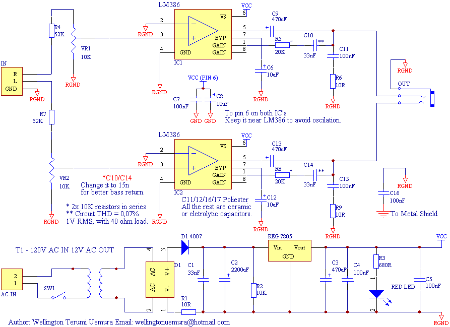

I have build 20 variations of the same Headbanger circuit. The main problem was the "hummm", noise and the BASS that was to weak.
So i came up with this circuit(based on headbanger):
No "humm" or "shhhh" (Hisss)
Better Bass response
Better volume control
Low distortion in max volume
No oscilation
No ground problem
Please note that i am not a electronic engineer nor i do have equipament to make technical documentation about this circuit, the only thing I had was my ears. :lol:
This device was tested with xbox XBMC and SONY **broken link removed** headphones.
With songs from nirvana, guns, eminem and so many, the bass response gives a big punch (compared with the original), very clean and smoth. If you do a teste with thouse "BASS test songs" like DJ Magic Mike Bass Test, you can feel the BASS pressure in your head, powerfull and smoth or if your headphone can keep up with the song "Deep ass bass song", for the first time i understood what the "Deep bass" mean, to strong!
I felt that i was throw up....no joke.
So, i will be very glad if some one could comment or give any suggestions about this circuit.
**** 08/27/2004 Schematic updated

how much current does this thing consume? because many people are only going to use a headphone amp when out and about, otherwise they'd use a normal hi-fi.
Don't get me wrong, I'm not trying to put your design down.
Tim
No problem grrr_arrghh.
I dont know how much this consume (now) because I am tired of making changes in this circuit, let me take a break and i will supply that information to you.
I also have a hifi and a complete Home Theater set with **broken link removed** projector etc to watch DVD and hear music, but i use this in my room since there is no sound isolator, i've build this circuit to play xbox games and hear my mp3 in it without the need to power on my 900W computer just for that, i have a good 5.1 amp in this computer and like to listen mp3 from it, make the windows shake but my neighbors don't enjoy that as I do, so...
To make it portable you can add a **broken link removed** and make a Step-down Switching Regulator as many diskman/walkman/portable mini-disc uses to help boost batery life a bit.
Here a example of a **broken link removed** circuit with board and here a few more examples and explanations about **broken link removed**.
This circuit solves many problems from the original headbanger, so i still want to hear some comments about it.
Thanks :wink:

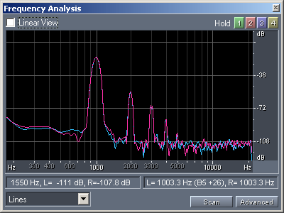

Hi Wellington,
Are the plots good? No way! The output should look almost like the input.
They show an awful lot of harmonic distortion, more than a few percent, which is much more than a basic LM386 and very much more than the original Headbanger circuit. I hope that those plots were measured with a load, because if they weren't, then the distortion will be even higher when loaded. View the output's sinewave to ensure that the amp isn't clipping.
Your choice of a low value for C7 and C13 eliminates many benefits of the original Headbanger circuit, such as lower distortion at low frequencies and extended low frequency response, but it does give a little bass-boost.
The LM386 is not designed to have a capacitor to ground on its pin 8, which is probably where your excessive distortion is originating, especially the unusual even harmonics. Instead, using capacitors with a much higher value for C9 and C15 would probably reduce the ON/OFF "pop" (but cause a turn-on delay).
The input capacitors C5 and C11 are not necessary (and their values are much too high anyway) because the LM386 is designed to have its inputs biased at ground, which would come directly from your volume controls.
Sorry Wellington, but nice try. There are many good headphones' amp chips out there, but most are SMT only. Try experimenting with an MC34119, which is a small bridged amp not requiring an output capacitor. With a gain of only one, like your circuit, its distortion should be vey low. Its datasheet is here:

Now that the dummy load are in place i've done a few more tests (1Khz sine wave) using the Sample Champion from Pure Bits so i could check the THD and see not only graphics but numbers.
This is the result of circuit based on my schematic (no changes):
With C8/C14
(Tone 1 = f1) = 1001 (Hz) = 5,6 dB rms
Freq.(Hz) Harmonic Value (dB rms)
2003 (2*f1) -27,1
3004 (3*f1) -61,1
4005 (4*f1) -36,8
5006 (5*f1) -58,4
6105 (6*f1) -73,7
7031 (7*f1) -85,3
8086 (8*f1) -88,3
9162 (9*f1) -93,5
10099 (10*f1) -84,5
THD = 4,4410%

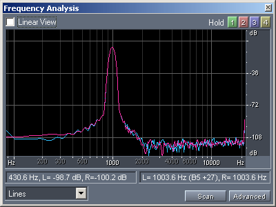

Now the same test Without C8/C14:
Without C8/C14
(Tone 1 = f1) = 1001 (Hz) = 6,2 dB rms
2003 (2*f1) -46,5
3004 (3*f1) -63,6
4005 (4*f1) -40,8
5006 (5*f1) -49,4
6105 (6*f1) -71,5
7031 (7*f1) -61,3
8043 (8*f1) -87,3
9076 (9*f1) -87,8
10088 (10*f1) -83,2
THD = 0,5341%

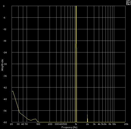

There is a japanese that did a few more test with the headbanger and like many others, he find out that the original headbanger was not that good as the author say it was. If some one understand japanese you can see all the technical tests he did **broken link removed**.
And like the test he did, you can get better results if R4/R7 (my schematic) has 20K resistors, so i did change R4/R7 to be 20K and this is the final results:
2003 (2*f1) -56,9
3058 (3*f1) -76,2
4005 (4*f1) -68,3
5103 (5*f1) -89,1
6105 (6*f1) -75,1
7095 (7*f1) -87,0
8107 (8*f1) -89,3
9055 (9*f1) -85,2
10099 (10*f1) -84,2
THD = 0,0935%
Now i think this is a better result :D
I dont want to flood the forum with plots, so this is the final plot, I think it could be better but in my tests the sound get more flat killing the bass response, and for a cheap head amp i dont think it could get any better with the bass that i like (personal taste).
Once again thank you audioguru for your help and i will try the MC34119.

Hi Wellington,
I'm glad that you got the distortion down to where it belongs, an improvement of more than 47 times lower! Removing your capacitors C8 and C14 to ground at the LM386s' pin 8 made a big difference. Increasing the value of your feedback resistors R4 and R7 also helped, by eliminating the "snapback" distortion at low supply voltage (like you are using) as mentioned by the author of The Headbanger, and eliminating the instability (severe ringing with sharp transients like square waves) as reported by the Japanese gentleman.
Now that your feedback resistor values are increased, your bass-boost is reduced from your original 8dB at 100Hz (National's bass rolls-off because their output capacitor is only 220uF, and is driving 8 ohms), to only about 4dB at 50Hz. You can return the boost frequency to 100Hz by reducing the value of capacitors C7 and C13 to 0.015uF, then the bass will be almost what you like.
It is too bad that you can't get rid on the turn-on "pop", but that's what happens when the output capacitor charges quickly through your headphones.
Remove C5 and C11 and replace them with jumper wire since they don't do anything. Try shorting them to see (hear?).

Hi Wellington,
Your final circuit is almost identical to National Semi's, isn't it?
But their datasheet for the LM386 doesn't mention the "snapback" distortion at low supply voltages that was discovered by the author of The Headbanger.
The MC34119 is bridged, therefore stereo headphones will need to be re-wired to be 4-wire.
