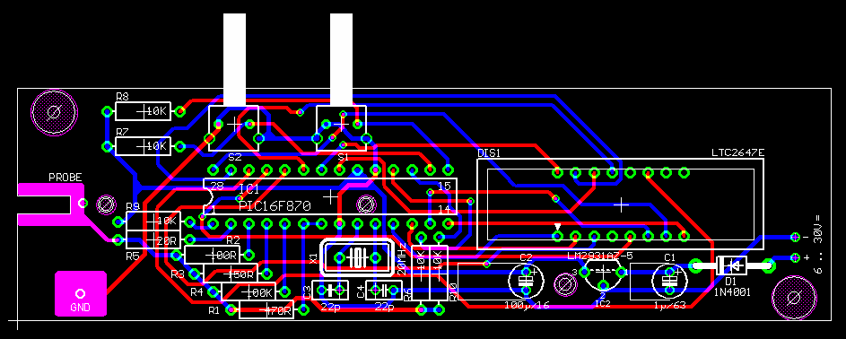

there are many publications about the super probe in the internet. All of them have one thing in common: They use a strip board for the circuit.
I guess the super probe is just the right tool for newcomers in electronics since it offers 17 functions.
The only change I made to the circuit was adding a reverse polarity protection diode for the supply voltage.
Everybody interested in a suitable layout fitting into a "FUTURE BOX No. FB 02" might email me for the Eagle files.
The buttons used for the board are tactile soft touch buttons with a metallic frame for robust handling.
Board dimensions: 4.5X1.28" (114X32.5mm)
Take a look.
