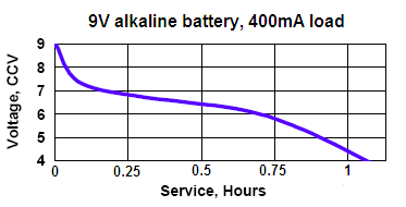

The amount of power in a little 9V battery is so low that you will see the LED dim as the voltage of the battery runs down.
Here is a 400mA load on a typical 9V alkaline battery:
