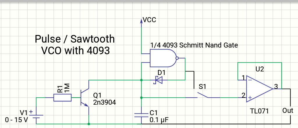

I seen something like this online and decided just to try it out. Was surprised that it is fairly linear. Not up to the standard of say an lm331 but for such a simple circuit pretty good. Also the sawtooth waveform ( descending ramp ) is also pretty linear over the full range of the vco. By adding a monostable to the pulse output you could get voltage controlled pwm. I expect it would drift with temperature, though there are probably ways of compensating for that, but that would be contrary to the principal appeal of the circuit, that it is very simple!
You have already said it. There are no ways to thermally stabilize CMOS, there is also large variety of them.

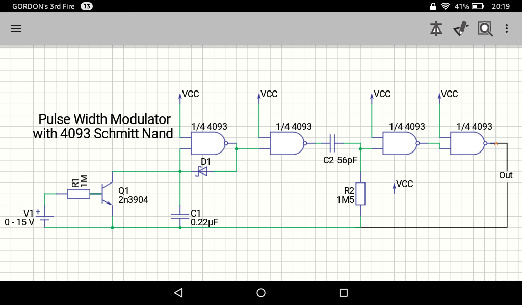

PWM augmentation with range of 2 - 93% duty cycle over 0.5 - 15 volt control voltage input

Simpler pwm circuit using only 1/4 of a 4093. The duty cycle range is smaller with this one, about 10-90%

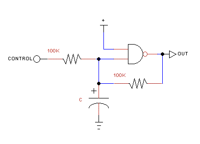

zahwi, that's a neat trick - I've built oscilators from Schmitt inverters plenty of times, but it never occurd to me to vary the pulse width by simply adding another resistor...

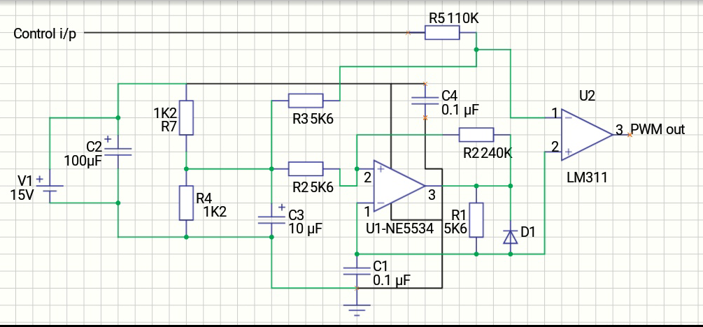

Like most simple circuits this one has many limitations. The biggest disadvantage is that the frequency also changes with duty cycle. Also hysteresis changes a lot with temperature. It can't be used in mass production because different makes have different hysteresis.
This is a better PWM circuit that I designed a couple of weeks ago. Can also work with a reasonably fast dual opamp e.g. NE5532. C1 can be decreased for higher operating frequency. With C1 as shown TL071 / 082 should be fast enough for U1.

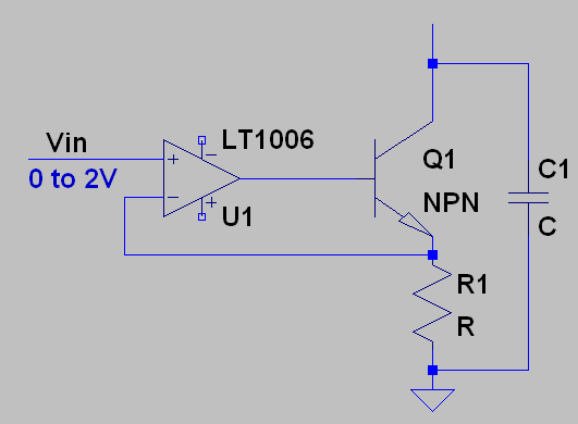

Your Voltage to Current (Q1) has many problems that you are probably tired of hearing about.
The gain of the transistor is a major player in the temperature problems. Also the B-E voltage is a problem.
By adding a op-amp and resistor; the Vin is across R1. So the current is very predictable. Q1 gain is not in the formula. Also the B-E voltage is of no importance. Vin can not go very large. If you need 0 to 15V add a voltage divider. (two resistors)
Sorry not so simple but very linear and stable. Op-amp must work with inputs near ground. So chose the right part.
There is a two transistor (no op-amp) version if you are interested.
Thanks Ron. This is a voltage controlled current source ( well sink if we're being pedantic ), my only concern regarding this would be the compliance range of the transistor, though with the lower threshold of the 4093 around 5 volts this probably wouldn't be a problem. Still the problem of the thresholds of the 4093 drifting with temperature still remain. I suppose you could attach a small heatsink to it, but that's just getting silly when a fast opamp or comparator would do a much better job!

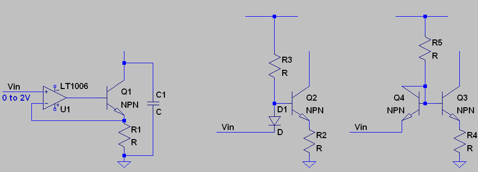

Is the 2 transistor option a current mirror by any chance?
Here are three options.
We talked about using an op-amp. It puts Vin across the resistor.
The middle circuit; D1 causes the base of Q2 to be one diode above Vin. This way Q2-emitter is very close to Vin. So Vin is across R2. The problem is D1 and Q2 are not equal. Close but not equal.
The right hand circuit use a transistor to get a closer match in voltage drop. Q4 is the same type as Q3. In a IC all transistors are made of the same piece of silicon, at the same time and should have the same temperature. (note we are not just using the B-E junction, we are using the C also)

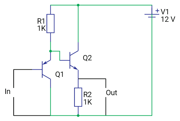

I never thought of that idea. Reminds me of a similar circuit that uses a complementary PNP to do the voltage shift.
