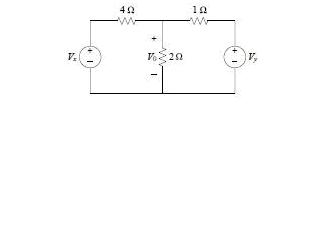

Hi All,
Please help out on this.
I manage to get Vx = 28V and Vy = 9V.
Please check whether correct or not.
Thanks & Best Regards,
Micheal

Hi All,
Sorry for miss out the question:
The question is asking to get the Vx & Vy Voltage value by using the Superposition theorem.
For the solution:
I have tried to short each of the voltage source for this calculation.
By the time I want to short the voltage source on the left, wonder how is the current flow is? Is it the same when we short the voltage source on the right?
Btw, the answer I got is Vx = 28V and Vy = 9V.
Please guide and check whether the answer is correct.
Micheal
Oops.... Miss out the below details. Sorry...
Given V0 = 8V and the power dissipated across resistor 4 Ohm is 100 W
Find the Vx and Vy?
If 100W in 4 ohms, then V(4ohms) = (100 * 4)^1/2
Then using mesh on left: Vx = 8V + V(4ohms)
Now, substituedthis into the equation from superposition, and you have Vy.
