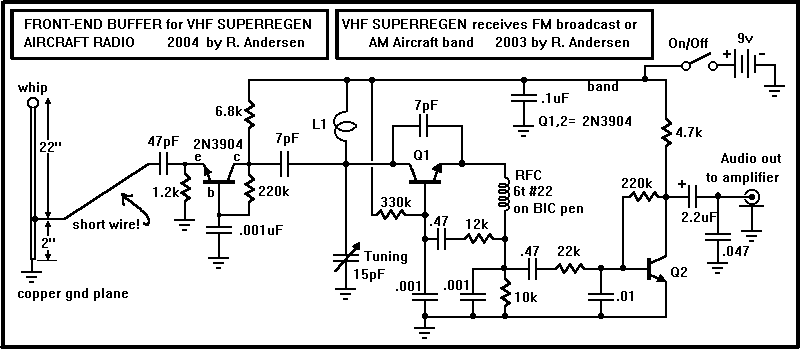

Andersen has a proper way of doing it:
1) The high impedance tank is at the transistor's high impedance collector.
2) A capacitor from collector to emitter provides positive feedback.
3) A few parts at the emitter provide a quench oscillator.
4) An RF amplifier isolates the antenna from the RF oscillator.

An "equation" for a very small value capacitor that is used for positive feedback doesn't work. Stray capacitance and the capacitance of the transistor are up to double the capacitor's value and are unknown.
All VHF circuits like this use a capacitance of from 4.7pF to 10pF and they all operate fine.
If the value of the capacitor is a little too much, then the positive feedback is a little higher than necessary and the circuit is able to oscillate down to a lower frequency. If the value of the capacitor is a little too low, then the circuit will not oscillate at a frequency as low. So what.
The value of the capacitor that is used for positive feedback affects the tank's tuned frequency a little. So what, the tank must be tuned anyway and the value of the capacitor to tune it isn't a linear function of the frequency, and stray capacitance across the tank affects its frequency more anyway.

Of course. The inductor at the collector is the tank coil with some stray capacitance across it.
I'll take the LC circuit in the emitter as is.
Why? An LC tank is at a transistor oscillator's collector, not at its emitter.
A transistor is cutoff by a voltage change between its base and emitter. That is where the parts should be located for the quench oscillator.
You have the parts in your circuit mixed-up and backwards.

Thats different. When I went to:
and looked at his circuit, he states:
Q1's emitter has a 6 turn RF choke connected to it; below that choke are a 10k resistor to ground and a .001uf cap across that resistor. These 3 components form a subcircuit that makes the superregen unique: the Quench Oscillator. (The 10k resistor is also the emitter load across which we take audio which is sent to the second transistor, Q2, for amplification).
The .001uF cap across the 10K resistor forms an RC time-constant circuit that sets the "quenching frequency".
He is agreeing with me.
I think it is just two components (resistor and capacitor), and you are saying it is the capacitor and inductor.
My resistor capacitor and inductor are connected together the same way. except the other end of the inductor is connected to collector and the resistor and capacitor are pull-ups instead.
