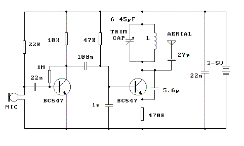

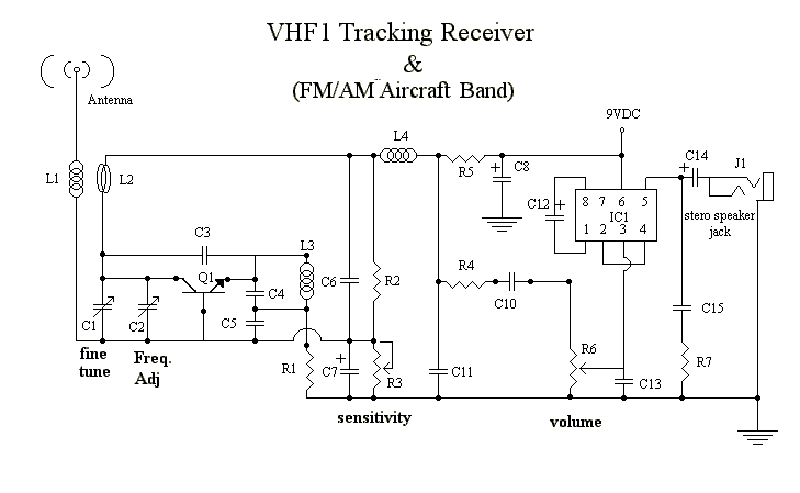

I went against the better judgement of some members of this board and built a superregenative radio receiver, not becaue i'm rebellious, but didnt have much else to do. I also wanted to see how it performed so that someday I can incorporate it into a proper radio receiver that actually uses IF amplification for gain, so that I can have an even more sensitive receiver.
I can hear aircraft very clear with this thing, but I can not hear my bug very well. I practically have to shout into it to hear over the radio. I imagine that maybe I need to lower the resistnce of that 47k that biases the oscillating transistor or something?

The super-regen radio receives AM, which is what aircraft use just above the FM broadcast band. A super-regen doesn't receive FM very well, you have to tune it to one side of the station so it "slope detects". Maybe you have tuned the side where the AM part and FM part of your transmitter cancel.
I just discovered something that might narrow things down, before I go and do circuit surgery.
The transmitter will not make the oscillating sound unless it gets really close to a speaker.
when i cut the power to the superregen though, the transmitter can be pretty far away from the speaker, and will oscillate for a second until all the power is gone from that 1000uf capacitor.
In other words, it seems that the superregen will receive the way I want it to for a second after the power is cut off.

Congratulations. Now if you want to change parts, only change the values of the tuning capacitors and the sensitivity resistor. It seems that the higher the value of the sensitivity resistor, the more stations you could get, but then some local stations could jam if you are close enough to them in frequency.
I find it much better to use small values for the capacitor connected between the battery and the transistor's base. Also, I use a 0.1uH inductor because Big resistance to me means less power.
You will need to experiment with the values of your parts. Try to not go under 500 ohms in resistance in any circuit or something might blow up or fail to work.

And check your antennas. They should be between 6 and 12 inches. If you follow the wavelength formula, (where antenna metres = 300 / frequency in megahertz) then you will get a nice long antenna (2 - 3M), but you will receive better reception and transmission.

Ive been slapping in different capacitor values and have goten in the whole FM band, but like audio said, i can't hear it very well.
I'm going to try to get my transmitter working with the receiver before I do anything else.

Russ, Im not sure if what you said applies because this transmitter works just fine with regular radios. Should I still try that?
btw, I am using 2n3904's for the transistors of the transmitter.

Regular radios may have special circuitry inside them. If your transmitter works well with a regular radio, place your superregen the same distance from the transmitter. If the response is the same in both units with the exception of volume, then you should be OK.

Of course they do. A regular FM radio has all the things that make an FM radio work well that a super-regen radio doesn't have: RF amp, IF amps which make a very high-gain limiter, many tuned circuits with the proper bandwidth, a "real" FM detector and automatic RF gain control.

It sounds like its sensitivity control is too coarse. You can get better resolution by adding a resistor in series with it and using a pot with less total resistance.
1) Adjust the sensitivity control to the position where it is the most sensitive.
2) Disconnect the control and measure its resistance.
3) Install a pot with its total resistance 1/3 the measured resistance and connect it in series with a resistor that is 83% the measured resistance. Then the new pot will adjust from 83% to 116% around the most sensitive resistance.

As Audioguru said, a super-regen is an AM radio receiver, so it will have very poor performance with an FM signal. Slope detection probably won't work very well because of the pathetic selectivity of this type of receiver.

The bandwidth of a super-regen reduces as its sensitivity is increased, so it will sound very distorted and muffled with no treble. It will sound like CRAP!
As I said before, measure the resistance of the existing pot when it is adjusted to max sensitivity, and if you use a 10K pot, use a series resistor that is the resistance that you measured minus 5K.
It probably won't have enough range of adjustment to be able to reduce the sensitivity for strong signals. Battery voltage will also affect sensitivity and it probably won't work any more when the voltage drops a bit.

Sure, but then it won't have any "gain". Reducing the Q of the tuned circuit will be like turning down the sensitivity control.
Well, i give up :lol: . I did what you said audio and got it to oscillate, but it's still nearly impossible to find the transmitter for one thing because I have to mess with sensitivity AND find the station @ the same time. and when I do find the station, its very hard to keep it there. and yes, sound quality is crap. don't rub it in too hard nigel :lol:

100K in series with the pot is much too high since the original pot was 50K (on the schematic) and its setting for max sensitivity was much less.
Put a resistor in series with one end of the new 10K pot and its slider. The other end of the pot is one terminal and the other end of the resistor is the other terminal. With the pot set at half-way, the resistance between the terminals must measure the same as the resistance of the original pot when it was adjusted to max sensitivity. The smaller-value pot in series with a larger-value resistor reduces the range of the pot's setting so it is much easier to set to max sensitivity.
