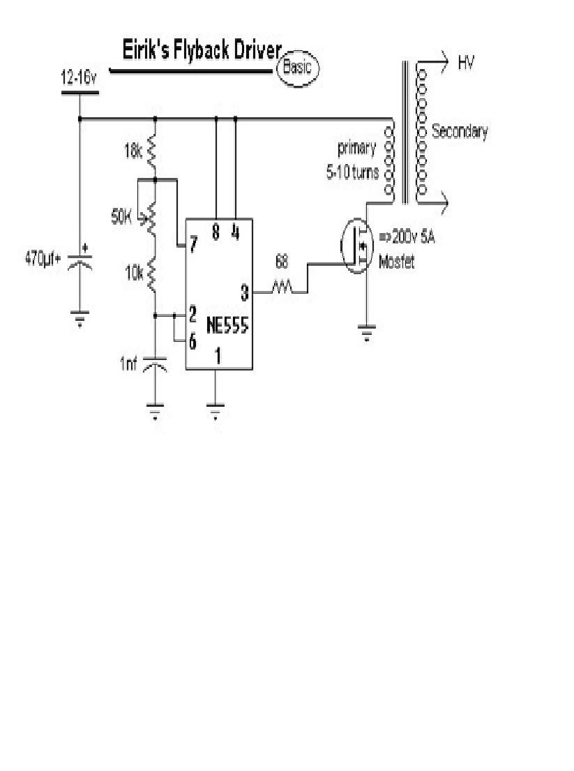

Want to build a jacobs ladder using a fly back from T.V. then using a quad multiplier will use Cap and diodes
Vin is 15 KV x 2 = 30 KV for Cap and Diodes

By the time you add the Voltage Multiplier, you won't have much current left, for a Jacobs ladder.
