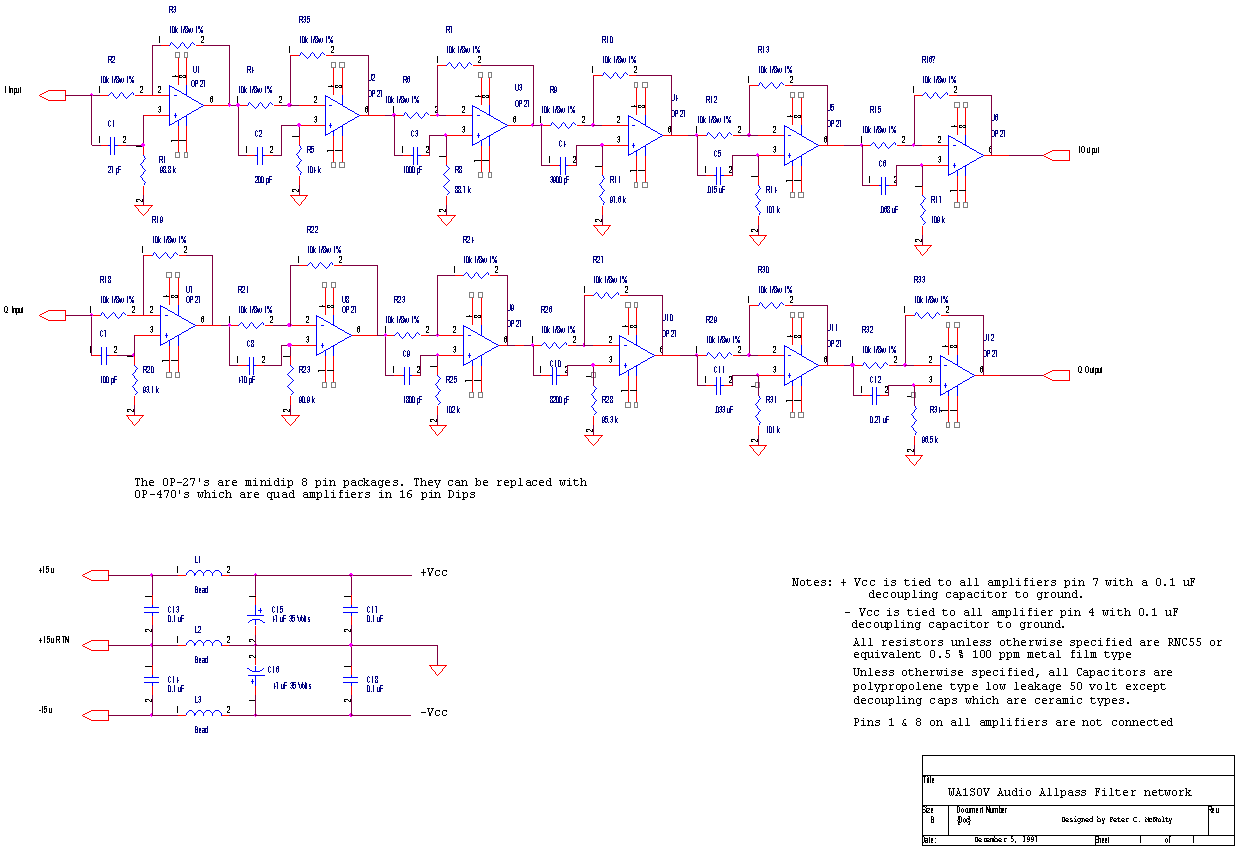

For example see this filter too.
It looks like the circuit needs a dual supply for the Op Amps while I want to connect its output to a single supply circuit(the positive and ground will be common for 2 circuits), but I don't know how to do the job?
I fear which could not get a perfect response If use dual supply for the filter while the second circuit has a singel supply....

The analog circuit has an idle output voltage of 0V and its output swings positive and negative up to about 13V peak.
1) Why feed an analog signal to a digital circuit?
2) The negative swing of the signal to the input of TTL logic will destroy the TTL.
3) The 13V swing to the input of TTL logic will destroy the TTL.
You need to modify the signal so that it fits into the TTL input voltage range of 0V to +5V. Attenuate it then add an offset voltage.

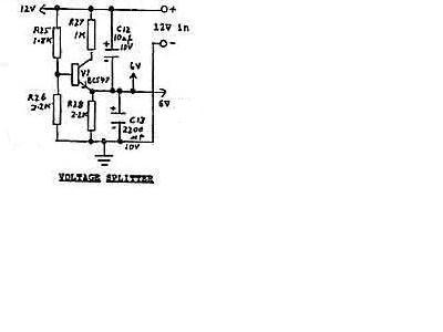

Why don't use a voltage splitter to create a virtual zero point like this pic?

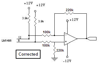

audioguru,
Here is another dual circuit from you for example which I follow an alternative to modify it to a singel ended supply?
Thats why I am saying I need a general response.
Your voltage splitter circuit has too many parts. An opamp just needs a two resistors voltage divider and a filter capacitor to make a virtual ground and work with a single supply.
You have a differential amplifier made from an opamp. Why?

As Audioguru has already said, all you need is two resistors and a capacitor!.
Can you let me have the configuration with 2 resistors for a Differential amplifier?
I know how to do the job for an inverting and non inverting configuration, but I am not sure how to do the job for an differential circuit?
The 'ground' connection (bottom of 220K) goes to the centre of the two resistors, it's as simple as that - however, if the inputs and outputs are DC coupled everything else has to be referenced to the same 'virtual' centre point.
What about the phasing circuit I have shew in the 7 post?
Just as above - bear in mind though with a simple two resistor method you have to be careful that the current demands per supply rail are equal to each other!.
