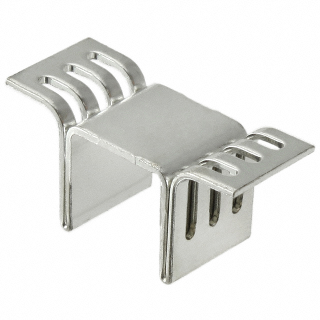

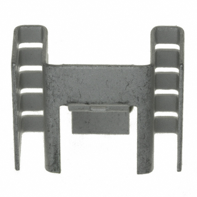

AE10774TR
I have this type. It needs to connect to copper and the copper connect to the hot part.
7109DG
I like this one.

AE10774TR
7109DG
I like this one.
I've used similar heatsinks, and they are very good at removing heat from SMT devices.
So good, in fact, that they are almost impossible to solder with your soldering iron......it will suck all the heat out.
You'll have to use a hot-air gun to preheat the heatsink and surrounding pad area before soldering it.
