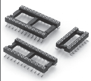

IC socket: Through hole to SMT.

I'll experiment tonight (with the cheapest IC's I can find).
I'll also try converting some of my sockets into SMD.
