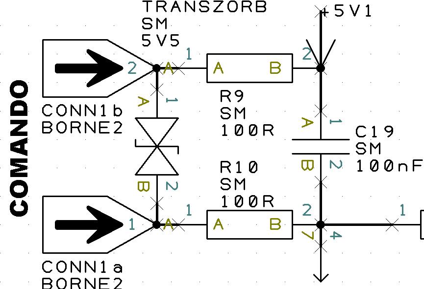

I have surge problems in my input. If I put 2kV pulses at 1.2us in the circuit attatched my microcontroller goes "crazy".
What do you suggest to do to prevent surge problems using my circuit?
The all schematic.
My pulses sources comes from an MIG (Modular Impulse Generator).
I thought to put a VDR between my inputs, but it's enough?
  • Esquema.pdf
Try putting the transorbs after the resistors, not before.
