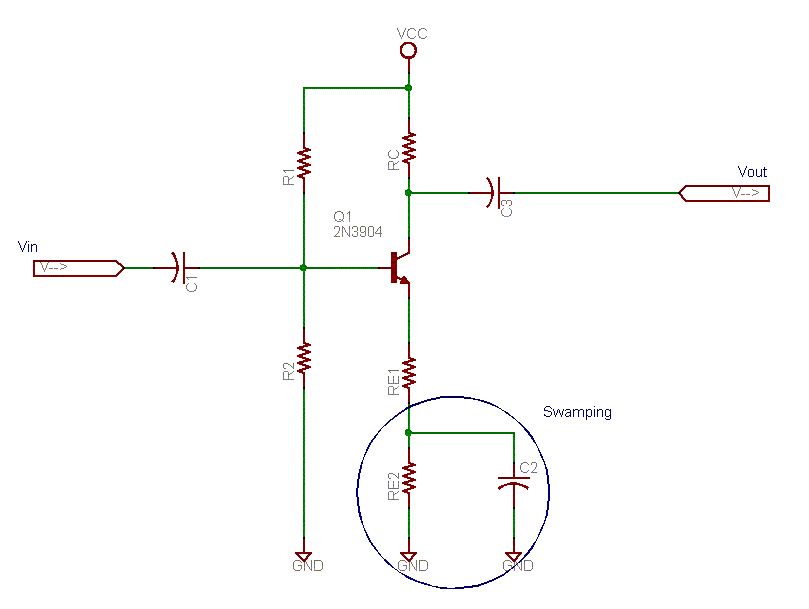

According to Floyd (Electronic Devices 7th ed.) swamping is a technique of using a partially bypassed emitter resistor to stabilize voltage gain. It reduces the effects of R prime emitter (internal emitter resistance of the transistor, which varies with temperature and emitter current.)
In this cct, both emitter resistors affect the dc bias, while only Re1 affects the ac voltage gain. So for gain, rather than Av=Rc/r'e+Re1 you have Av=Rc/Re.
